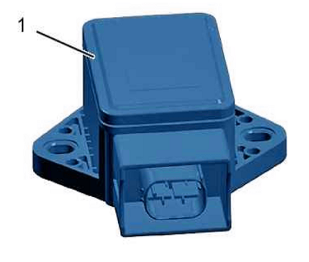

Ok so apart from U1305, all these are related tot he Gyrometer / Accelerometer sensor:
Gyrometer / Accelerometer sensor.
The gyrometer-accelerometer sensor is a piezo-electric sensor located under the handbrake. It is fitted on the vehicle in such a way that the connector is opposite to the direction of travel of the vehicle.
Its purpose is to measure the following parameters:
Yaw speed is the vehicle’s rotational speed around its vertical axis.
The lateral acceleration corresponds to the acceleration experienced by the vehicle in the transverse direction (axis perpendicular to the direction of travel) and appears in bends.
The longitudinal acceleration corresponds to the acceleration of the vehicle in the direction of travel.
The fault codes relate to both non-communication with the sensor and also internal faults within the sensor. The U1305 steering wheel angle sensor may be symptomatic of the other faults as the ESP / ABS ECU has gone into downgrade mode so will not be taking into account the steering wheel angle info for the ESP operation most likely.
As just about all these faults are to do with the Accelerometer, I suspect that is where your fault is lies. The fault descriptions are below, but will point to either the sensor or more importantly the supply voltage to the sensor. Now I have highlighted in bold the bit on C139B voltage being low and this is a temporary fault. But according to your diagnostic data, the supply voltage is perfectly within acceptable parameters of 12V.
The sensor itself has the following characteristics:- Nominal supply voltage: 14 V, Gyrometer-accelerometer sensor supply range: 8 V - 18 V.
Gyrometer-accelerometer sensor maximum supply current : 130 mA.
U1325: The time for recording the fault code is 100 milliseconds - No transmission of datastreams by the gyrometer / accelerometer sensor.
C1502: The time for recording the fault code is 100 milliseconds - Gyrometer / accelerometer sensor internal fault
C1315: The signal from the gyrometer / accelerometer sensor is monitored by the ESP ECU every 100 milliseconds - Gyrometer / accelerometer sensor internal fault
1310: The signal from the gyrometer / accelerometer sensor is monitored by the ESP ECU every 100 milliseconds - Internal fault in the gyrometer / accelerometer sensor
U1305: The time for recording the fault code is 500 milliseconds - No transmission of datastreams by the steering wheel angle sensor
C139B: Gyrometer-accelerometer sensor signal fault : Open circuit, short circuit to positive, short circuit to earth - The time for recording the fault code is 100 milliseconds - Cabling or supply fault (Undervoltage)
So if you are happy that the voltage is ok and it is within the operating range, then I would continue to suspect the sensor if the wiring and connectors have all been checked for shorts or chaffing.
- Yaw speed
- Lateral acceleration
- Longitudinal acceleration

It is part number 454921. A new one from Citroen costs £460.34 inc. VAT. Quite a lot inside that little box of tricks!

GiveMeABreak wrote: 03 Mar 2019, 18:12 It is part number 454921. A new one from Citroen costs £460.34 inc. VAT. Quite a lot inside that little box of tricks!
There a used one here for £10...
https://www.ebay.co.uk/p/CITROEN-C4-Pic ... 1109582939
Marc your a top man pal just bought it at that price its worth keeping a spare one !! give you all a update when it arrives I believe I will need Lexia to install it

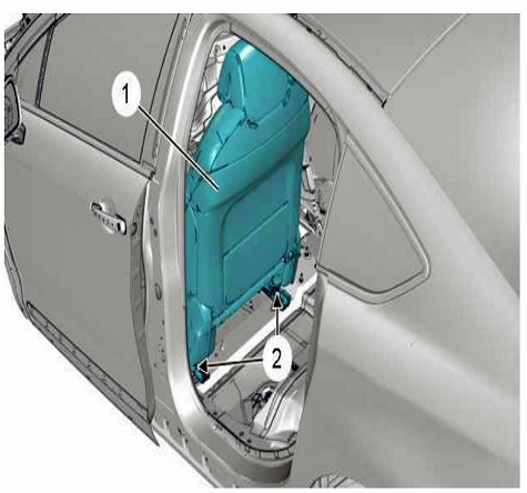

Perform the following operations:
Follow Battery disconnection part referred to in link and it is essential that you wait for the 5 minutes before disconnection to allow the airbags (inc. the one in the seat to discharge!).
BSI Reset / Battery Disconnect / Reconnect Procedure

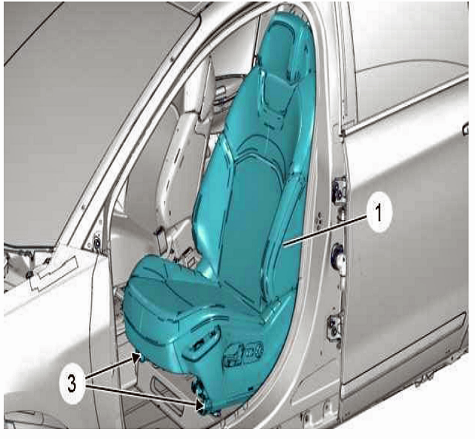

| Move the front seat (1) forward as far as possible. Remove the bolts (2). | Slide the front seat (1) rearwards as far as possible. Remove the bolts (3). |
N.B.: Tilt the front seat (1) rearwards (To make access to the connector easier).
Remove the front seat (1). |
Proceed in the reverse order to removal.
- Apply thread lock to the bolts (2), (3).
- Tighten the bolts (2), (3) to 2,75 m.daN .
- Reconnect the ancillaries battery. (refer to Procedure)
- Check that the electrical equipment is working correctly.
Follow part of this battery disconnect / reconnect procedure to disconnect the battery, complete the work required below, then follow remaining part of battery reconnect procedure:

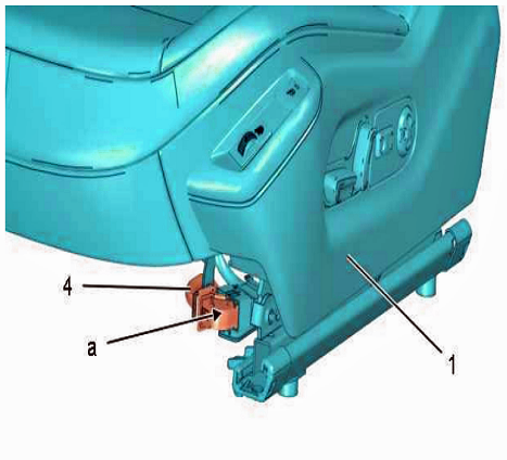

Release:
- The carpets (1) and (2).
- Remove the nuts (3).
- Disconnect the connector (at "a").
- Remove the gyrometer/accelerometer sensor (4).
CAUTION: Any gyrometer/accelerometer sensor (4) that has suffered an impact must be replaced
N.B.: Respect the direction of fitting of the gyrometer sensor /accelerometer (4) (Connector towards the rear of the vehicle).

[*]Position: The carpets (1) and (2).
Refit the Passenger Seat
- Reconnect the battery.
- Calibrate the gyrometer/accelerometer sensor; Using a diagnostic tool.
- Read the fault codes and clear them if necessary; Using a diagnostic tool.

In the photo, you can see it is contained where the green and tan parts meat at the seam. There is a black arrow showing the blow up of that section. It's important it is fitted in the correct direction as per the procedures too.
