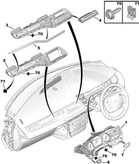

According to your VIN the amp option was not fitted as standard, so I suspect a retro fit. I will email you the specs for your car as it left the factory - at least you'll know what it had as standard. Look out for an email with a PDF.
As for your other question - again, it is not down to the models - the screen fitted depends on the Head Unit option fitted at factory.
As per your link, that RT6 is from a second generation C4 (B7) as the RT6 was not fitted to the MK I. It should fit fine, but you'll have to remove the fascia holding the screen on.
Secondly, be aware that there are 2 (not well known by the way) fascia panels available for the C5 X7 with large Colour display. One is slightly larger than the other and is needed for the RT6 and the High Res NG4 systems larger screens. Your RT4 one will not cover the new screen properly.
Item 2 below:
The part number for the fascia you require (in Nero Mistral - your colour scheme) is 823104 or 16069487ZD
Your original part number for the screen you currently have is 823156 or 16069486ZD
