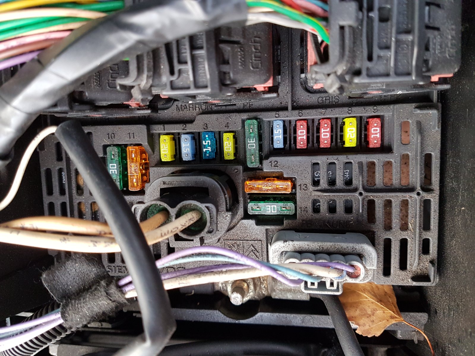

I have changed fuse 11 under the bonnet and still nothing. When you put it on you can hear a buzzing noise as if it's trying to start and clicking noises when I press the buttons and fluid is fine as well.

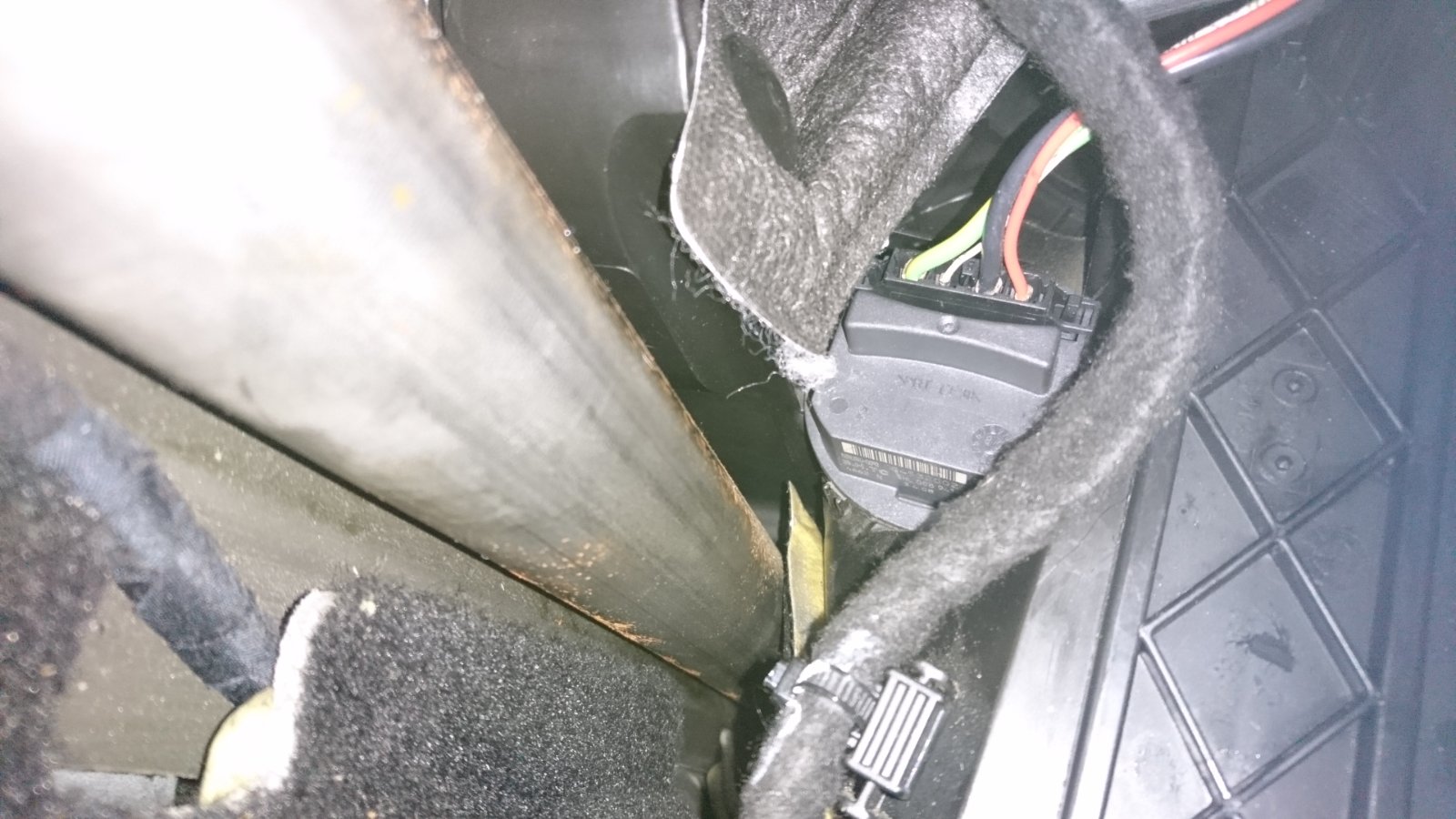

Hi Lia3110
Assuming yours is the same as mine then if you can remove the plug then bridging the wires is easy.
download/file.php?id=11903&mode=view
That is a picture of the plug showing the 4 wires.
With the plug unplugged put a wire across the Black and Green/Yellow wire pins, start the car and the try the blower, fingers crossed it works.
Switch off, remove bridging wire and plug back in.
Stat car, try blower, if all okay put trim back in place

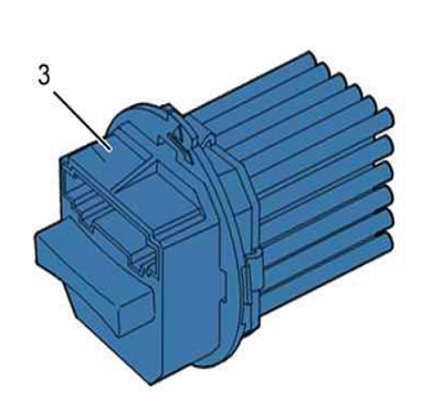

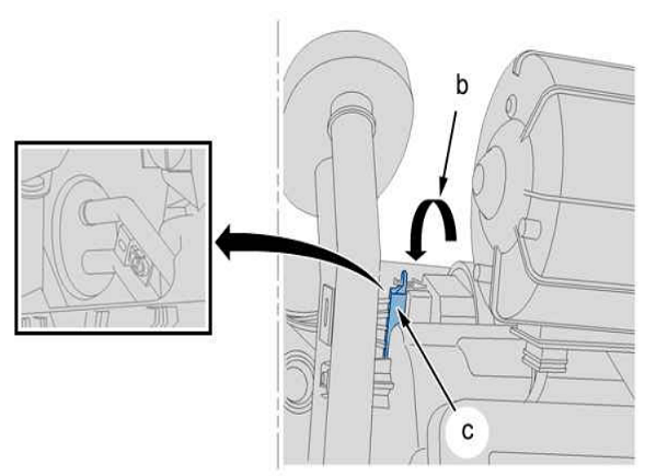

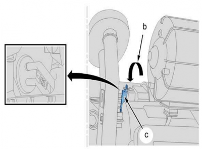

You'll need to remove the front passenger well side trim with a trim tool.
The Blower control module on your car is here:
... and it looks like this:
There is a connector on the end and the module is removed with an anti -clockwise turn

Hi everyone i finally got around to getting it sorted, it turns out it was the under bonnet fuse box that was the issue and i had to replace it.
Thanks so much for all your help and suggestions
Leanne
