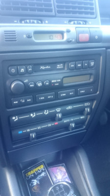

I had one like this on my -00 Xantia HDi:
Replacing with aftermarket -player was easy, and even dash looked fine when closing the lid. I had incartec's or similar adapter-wiring kit and steering wheel buttons worked fine with Kenwood DSP-CD-player.

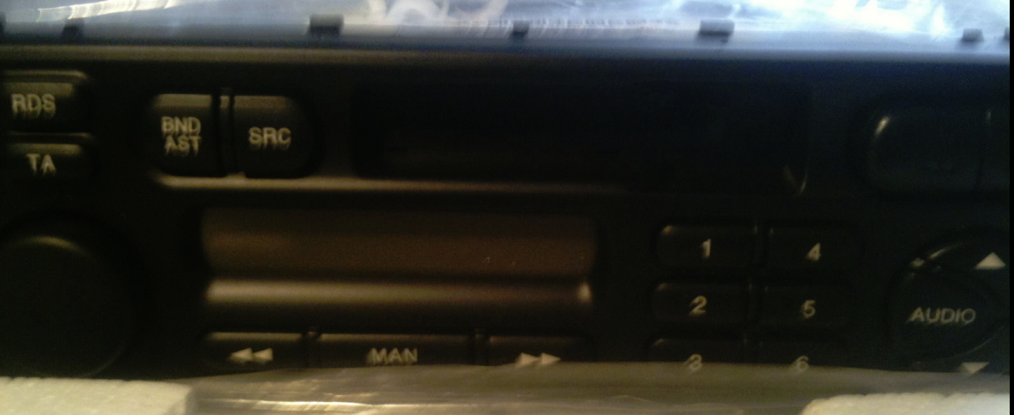

The original unit on the Xantia from your VIn as a "RB1" RDS CASSETTE AUDIO SYSTEM
The part number is: 656439.
There is a brand new one on a listing here:
https://www.ebay.ie/itm/331856686308
Photo is a bit naf, but is a different unit to Marko's ^
You can get a CD Changer for it if required, but this is the genuine unit as shipped from factory.
