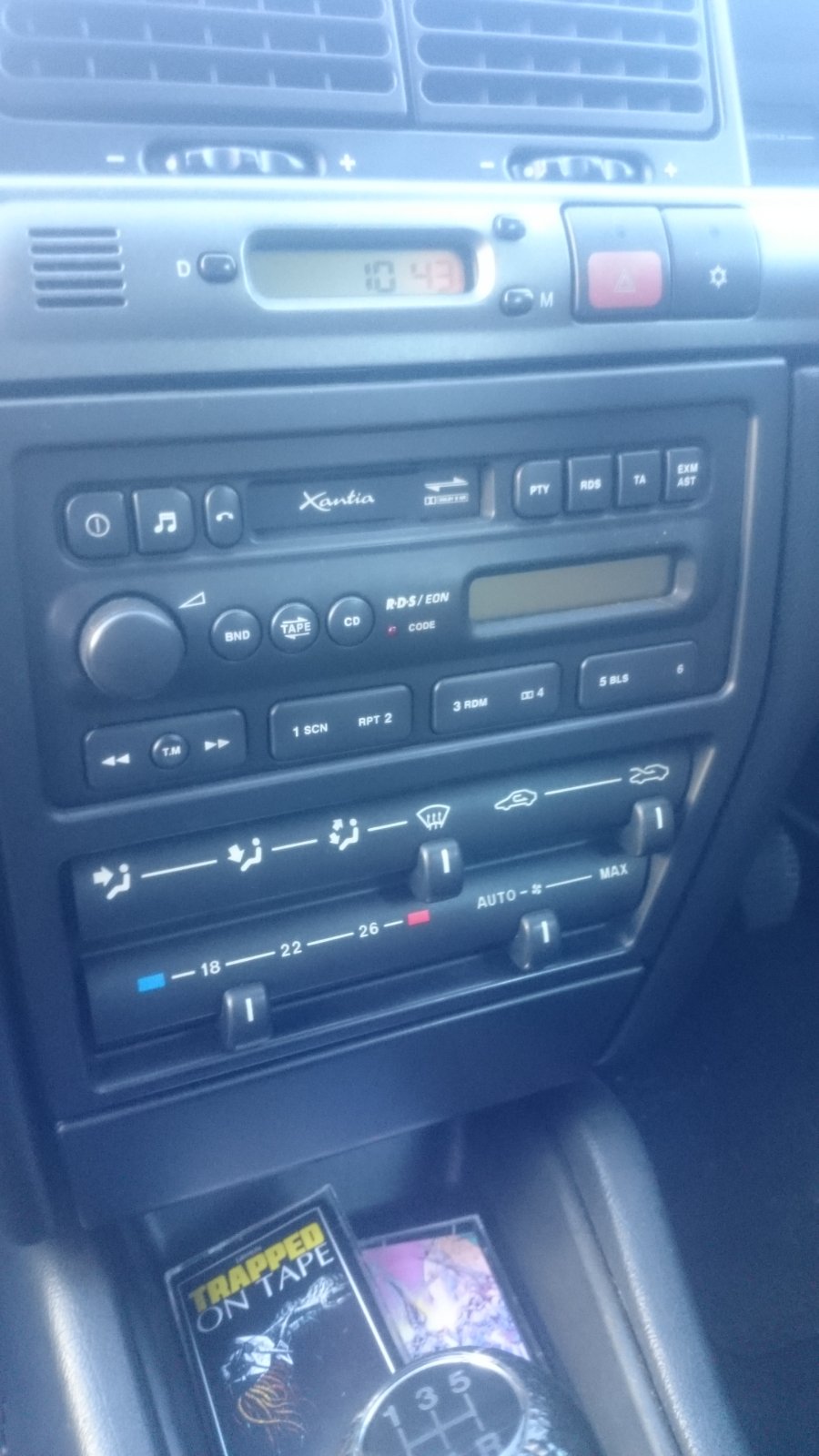

Re: Xantia 2001 - Radio replacement/ steering wheel buttons
I had one like this on my -00 Xantia HDi:
Replacing with aftermarket -player was easy, and even dash looked fine when closing the lid. I had incartec's or similar adapter-wiring kit and steering wheel buttons worked fine with Kenwood DSP-CD-player.

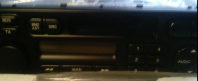

So the auction which Marc point me to (for brand new item) ended long time ago. But from description I can see that radio been fitted to Saxo, Berlingo and Xsara too. I found auction which I think could be a right one:
https://www.ebay.ie/itm/2002-CITROEN-BE ... 3149018663
Is there any other information (from manufacturer label) which I could check to identify if its a right radio - I'm guessing that I wont find original citroen part number on it but maybe something else ?
That looks to be the correct one. However - a couple of things - that unit was installed in a Berlingo - so may of been VIN coded - however on your Xantia, it won't have a BSI - so on those models they used a 4 digit radio code.
So unless you obtain the 4 digit code from the seller (if he even has it) you may be no better off.
I can't locate any more of those Cassette units, (and apologies for the link to the sold item). I know that the Xantia build number for the VIN you specified was 08808. They changed the unit from build number 08421 and again, but the latest unit for that Xantia is the one I referred to in my earlier post.
I think you may have to bite the bullet and get an aftermarket one instead unless you can source one from a breaker.

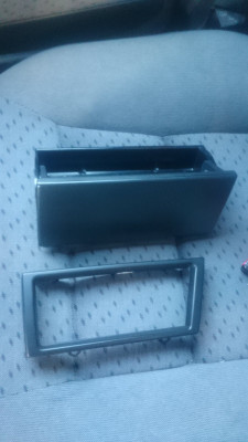

And maybe photo of my current radio and frames which I have :
A couple of things:
Is the cassette function essential? This will limit choice these days.
If it was me, I would be looking at it the other way round and find a Xantia compatible system first. For example, here's a complete Pioneer kit for the Xantia:
They can also supply the harness for the steering wheel controls on request, but their kit includes aerial and wiring adapter, plus it supports Bluetooth (phone and streaming), plus it is a DAB radio and includes an aerial. Not bad for the price considering a simple Yatour box alone will set you back £80 ish.
https://www.ebay.co.uk/itm/Citroen-Xant ... SwLEtYf3cd
