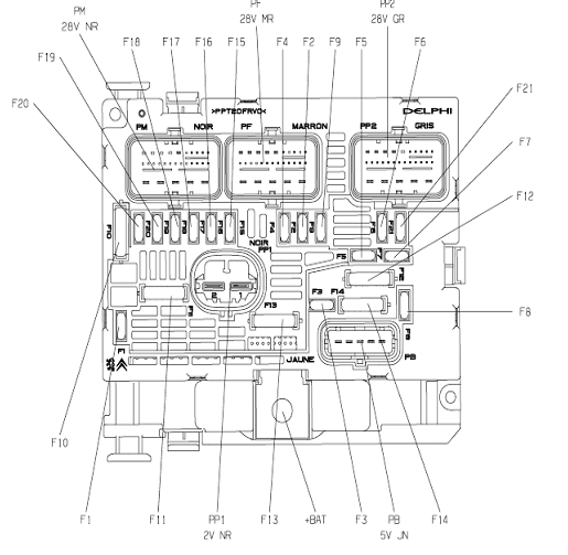

Some of the fuses may not be live all the time, so you need to test them with a multimeter (use it on the continuity setting).
Fuse F3 (10Amp) in the engine fuse box: Here's the location - this one is for the Front / Rear wash pump.

That one had blown and I replaced it but still no power. Not sure how to use multi meter. Know how to test voltage but that's all what does the cont settings look like
