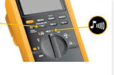

Some of the fuses may not be live all the time, so you need to test them with a multimeter (use it on the continuity setting).

Use the resistance range, denoted by the "?" symbol.
There may be a continuity setting at the bottom of the range that will sound a bleep when there is continuity.
Don't measure a live circuit using this range, extract the fuse to be measured.

As Steve says, or it may have a continuity setting with this symbol:
