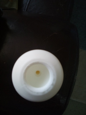

anyway pictures of the BUMP STOPS again.lol
Wide bottom is quite shallow recesss,The TOP view is a Small hole only about 4mm
Dia,,,not all the way through,about 1 1/4" Deep it looks like?.
SeeWhat you think,how the hell do they attache?..
forgot to post.??.

Re: Bump Stops xsara Picasso exclusive
Has anyone figured this out yet ? I’ve just bought some so wanting to know the trick
- Posts: 9270
- x 1930
The large end with the larger hole simply pushes on to a spigot. The spigot has a mushroom shaped head (IIRC!) to hold the bump stop.
Just a mushroomed head on spigot in center of cup holding bumpstop
Powerflex make them in polyurethane along with big bush on bottom engine mount for some inc diesels
Mine look just like in the photo above, there’s no hole in the thick end just an indentation.
Have you tried pushing it on? A bit of spit will help. Or soapy water if you're spitless.
Well, whilst replacing the brake compensator spring yesterday, one of the bumpstops fell off. Mine have a cup that holds the bumpstop in, this is then bolted into the chassis using an 8mm bolt. Both the cups are corroded beyond repair and I had to get a torch on the bolts to get them out. So now I’ve got no way of fitting the bumpstops unless I make up new cups !
