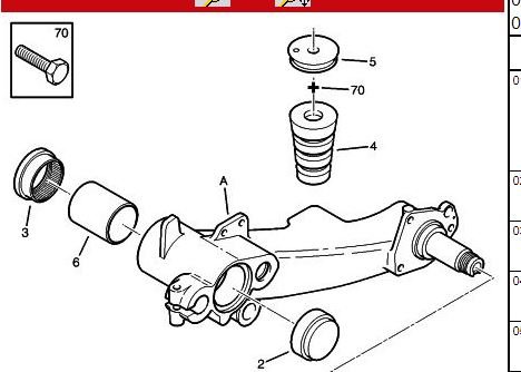

look at the parts diagram, are they just screwed into the chassis rail and have an end plate with a bolt sticking out, or a hole for a bolt to screw into it??
They may just fit into a cup.....
- Posts: 12567
- x 1485
Re: Bump Stops xsara Picasso exclusive
Appear to be bolted on, presumably from the bottom?
Actually, looking at it again, the bolt is shown only going through the cup (if it went through the stop I would expect it to be drawn below it) - and the parts diagram says it's only 16mm long, so I think it's a fair bet they're just pushed in.

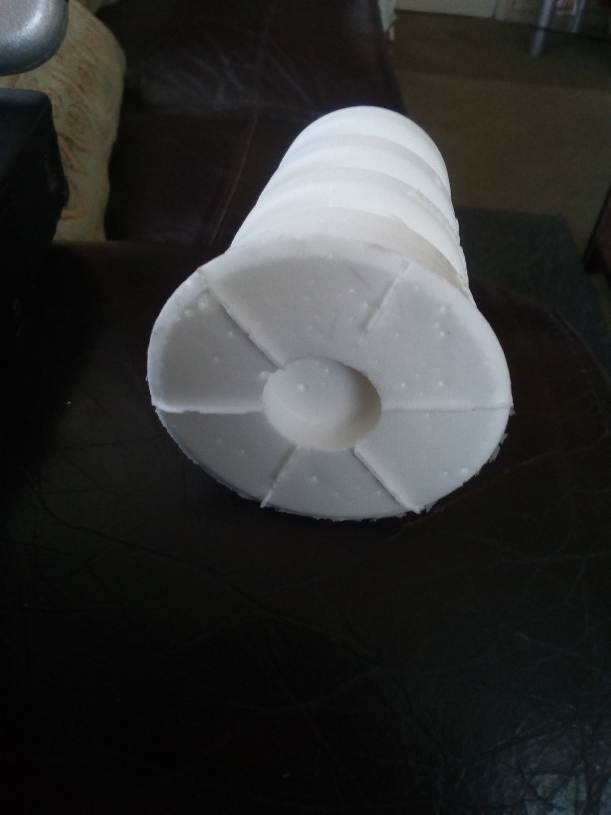

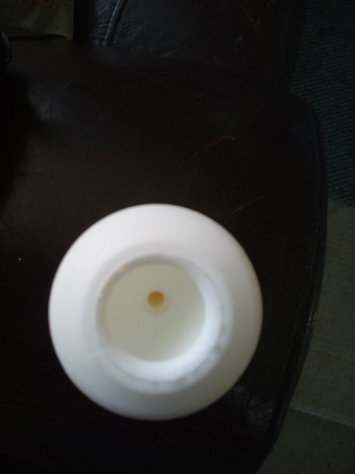

Wide bottom is quite shallow recesss,The TOP view is a Small hole only about 4mm
Dia,,,not all the way through,about 1 1/4" Deep it looks like?.
SeeWhat you think,how the hell do they attache?..
forgot to post.??.
anyway pictures of the BUMP STOPS again.lol
Has anyone figured this out yet ? I’ve just bought some so wanting to know the trick
OnlinePaul-R
- Posts: 9300
- x 1938
The large end with the larger hole simply pushes on to a spigot. The spigot has a mushroom shaped head (IIRC!) to hold the bump stop.
Mine look just like in the photo above, there’s no hole in the thick end just an indentation.
OnlinePaul-R
- Posts: 9300
- x 1938
Have you tried pushing it on? A bit of spit will help. Or soapy water if you're spitless.
