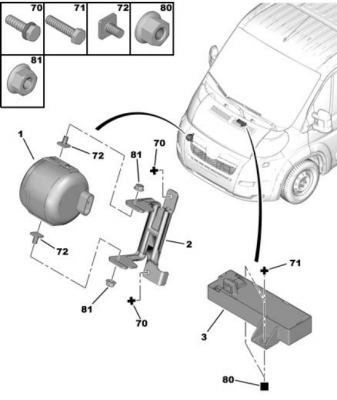

Hi, my relay van says on the dash alarm unavailable when I start it up, just wondered if anyone would know why this is? I tried testing it by locking the van with key fob and then opening with just the key, all the indicators flash but no sound. I haven’t had the van too long and it could of been there since I bought it I just didn’t notice. Any ideas anyone? Cheers.
- x 6955
Re: Alarm unavailable
Either the siren has been disabled or disconnected physically or via configuration - the rapid indicator flashing indicates a triggering of the alarm, but you're just not getting the siren going off. Lock with fob - unlock with fob fine, but lock with fob and unlock with key - triggers siren normally and flashing of indicators which is as it should be - so somebody may have nobbled it.
If you want to check the connections, I'll need your VIN posted here (will be masked automatically).
Jlm19900
- Posts: 10
- Joined: 29 Dec 2018, 23:14
Yea that be great thank you VF7**************[VIN obfuscated, can be read by forum staff]
- x 6955

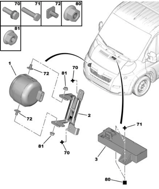

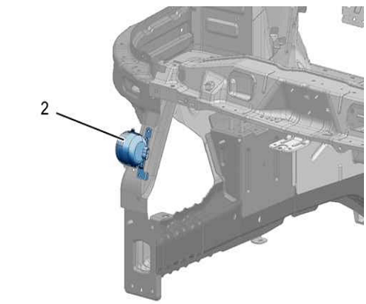

Ok, so after the ignition is switched on, in the case of an incorrect alarm system diagnostic test, the instrument panel receives a message containing the fault detected from the built-in systems interface.
The coded engine immobiliser warning lamp comes on, - on the comfort version instrument panel, a message is displayed on the dot matrix screen ("alarm not available" in the case of a failure of the alarm system, " vehicle intrusion detected" in the case of triggering of the alarm system).
So I suspect that in the case of the system on this Relay, there is a defective component, as the Alarm module can't be configured using the diagnostic tools.
Components of the System: Location of the Siren: So hard to say whether the Siren is faulty or the ECU itself

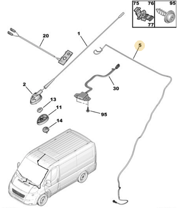

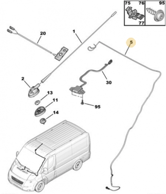

Thanks Marc, I will try and test the siren first. Do you have any of these diagrams for the radio antenna, just because my signal is very poor and only pick up radio stations in the city centre
- x 6955
Here's the aerial on your Relay. note that you only have items (1), (2), (5), (11), (13), (14) & (20)
(20) is the Aerial amplifier.
To get to the aerial the sun visor needs to come off and part of the headlining!
