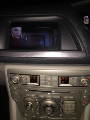

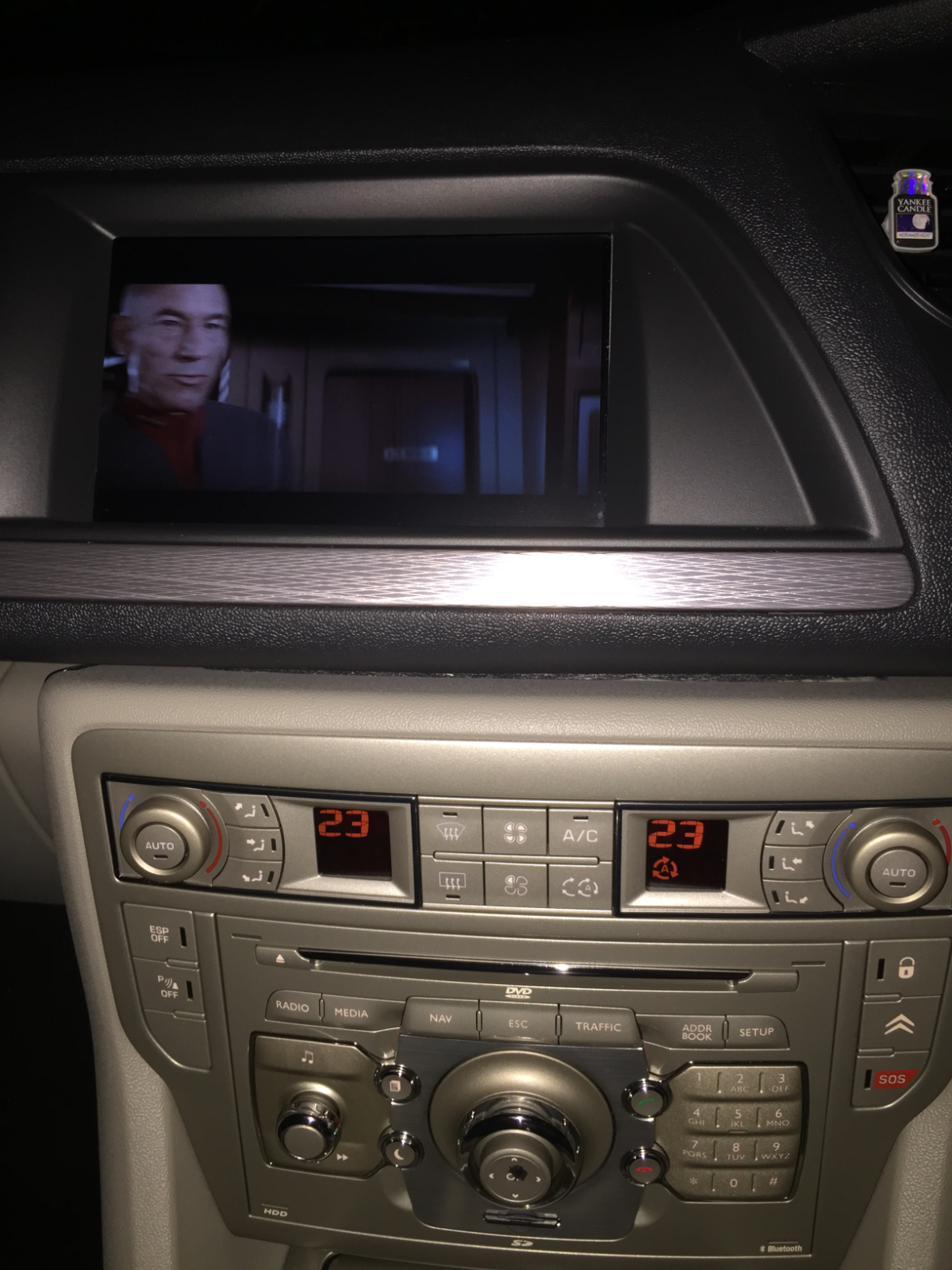

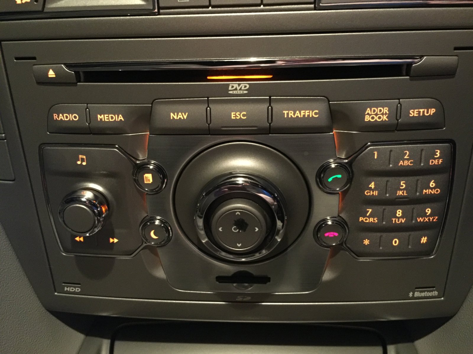

This is the NG4 Navidrive unit I have and shows where a double DIN goes. Yes you would need a new fascia and be aware there are 2 sizes (not widely known by the dealer) depending on any unit you fit.
There are plenty of PSA upgrade options to go- RT4, RT6, MyWay (RNEG) or the NG4 Navidrive 3D I mentioned.
Replacing any Head Unit with a non PSA unit will cripple certain features and options, so be aware of this as they are not just radio players of course. Also expect to loose steering wheel control functionality and some other functions if you attempt to put in another non OEM unit. Some additional harnesses may be available to provide some basic control - depending on the aftermarket solution, but not really recommended.
Most members use one of the PSA options as it maintains all functionality.

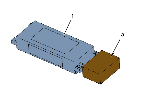

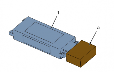

This is the Bluetooth Hands Free Module I was referring to:
I believe the RD4 is already compatible with this option. Bear in mind this list shows other equipment and options that won't be fitted to your car, but the Bluetooth Hands Free Kit is item 2, and this shows where it should be mounted behind the dash. There should already by the harness connection there that connects to the unit. The other end of this will be already part of the Quadlock connector bottom left connection. So once installed, and configured with Lexia, it should be ready.
The part for the Bluetooth Module varies according to build date and needs to be coded to your VIN, but should be either 6593G6 or 6593G5 and the mounting support is 6593NA.

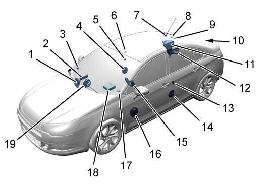

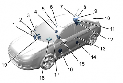

| (1) Audio amplifier . (2) E-BOX BLUETOOTH unit (Hands-free kit). (3) Tweeter (front right). (4) Speaker (rear right). (5) Tweeter (rear right). (6) Microphone (Hands-free kit). (7) Aerial AM/FM1. (8) GSM/FM2 aerial module. (9) AM/FM1 aerial module. (10) Antenna GSM/FM2 screenprinted into the rear screen. (11) Bass box . (12) Compact disc changer. (13) Tweeter (rear left). (14) Speaker (rear left). (15) Steering wheel audio control stalk. (16) Speaker (front left). (17) Tweeter (front left). (18) RD4 audio system. (19) Speaker (front right). | The Actual Hands Free Kit |

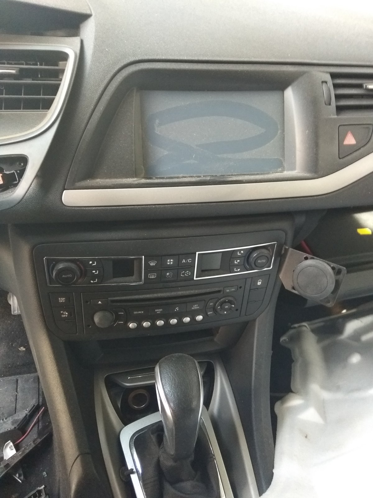

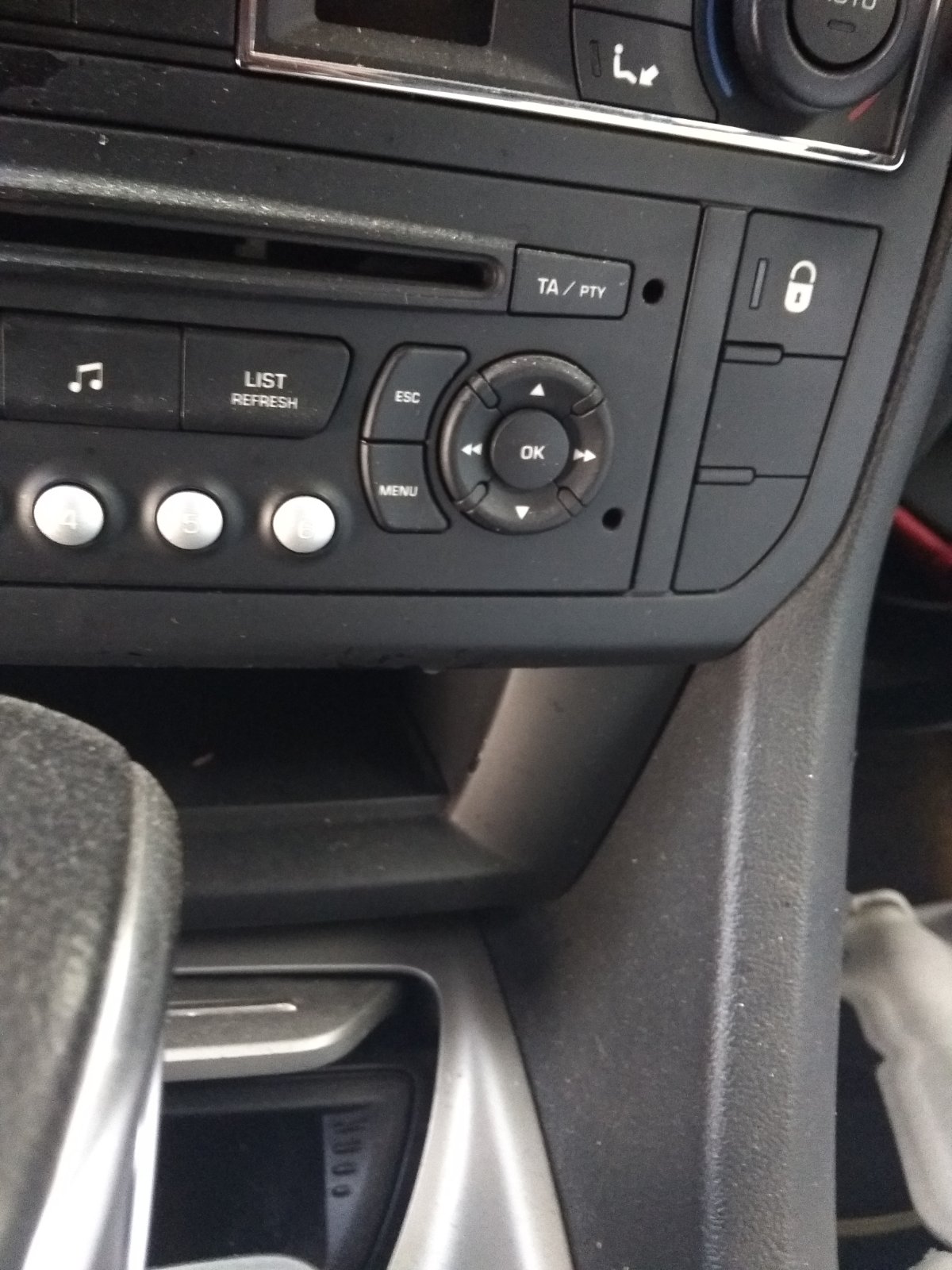

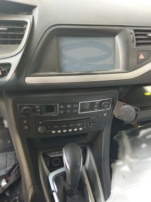

Thanx for your detailed response. I understood that this option - upgrading to RD45 is the easiest way, so in an attempt to find a RD45 radio, I went today to a breakyard. I was surprised to find there a X7 saloon , year 2010 , according to the yard's owner but it equipped with a double din screen instead of the MFD. again , according to the owner, it is original and genuine and was installed in later models. I've pictured it for you to see. the radio installed in the vehicle seems to be RD4 (pic attached) according to the explanation given by Marc (the writing on the knob at the upper right side). btw - this vehicle is equipped with shock absorbers , not the hydraulic suspension.
I will appreciate your comments.
Avi
Avi
- x 6953
Re: Hands free kit for C5 X7
Highly unlikely that this was fitted at factory - those screens were only fitted for systems with navigation. The RD4 or RD45 is NOT such a system. I suspect, although I can't confirm yet (subject to VIN), that the previous owner possibly originally had a MyWay or eMyWay (RNEG or RT6 / RNEG2 as they are also known) and has removed this before scrapping it as he / she knows that it can fetch a good price on the second hand market!
It looks like a standard RD4 was fitted in its place....
I can of course confirm all this if you can get the VIN for me from the windscreen aperture.

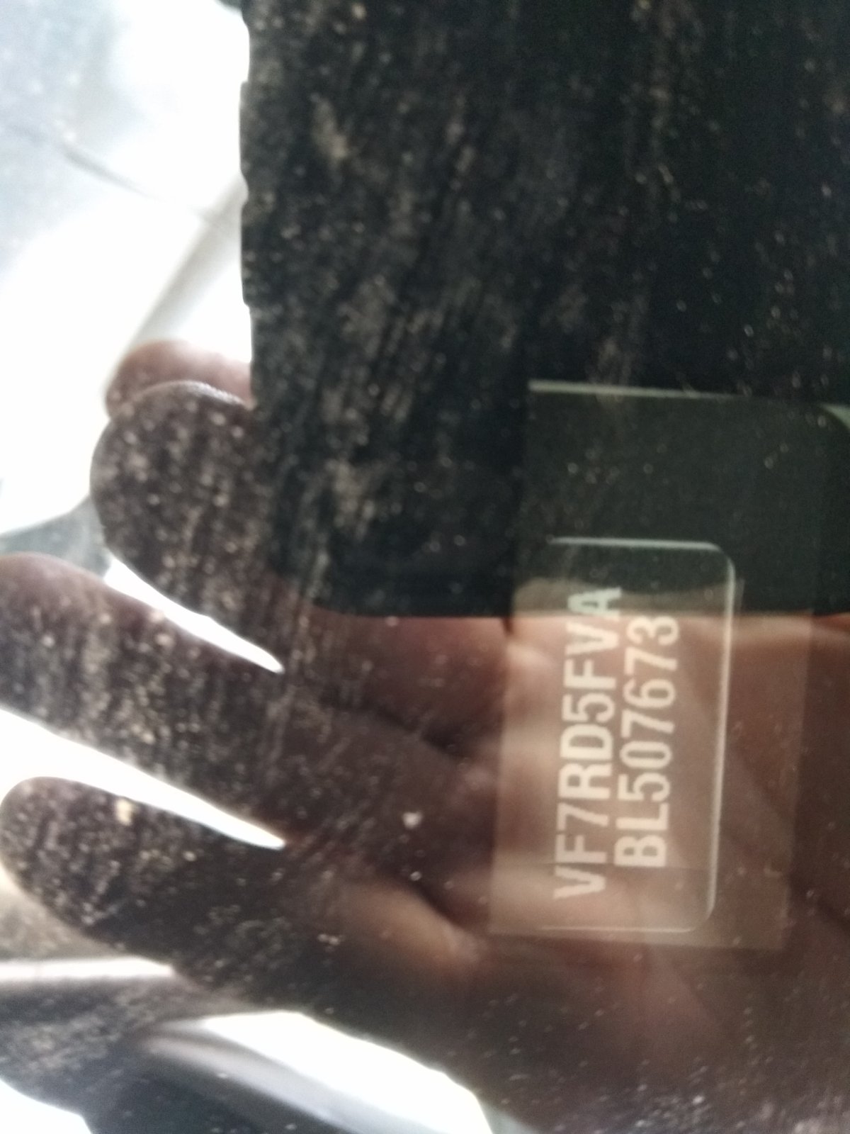

I've managed to take a picture of the VIN plate - so here it is. I hope it's readable.
Avi
Avi
- x 6953
Ok, I got that Avi.
My suspicions are confirmed!
This car was originally fitted with a standard RD4 head unit AND small standard Monochrome Level 'C' screen!
So the previous owner has at some point upgraded to one of the models I listed in my previous post - then after either an accident or scrapping it has decided to remove the head unit as it is relatively easily done, and replaced it with the original unit. Obviously he couldn't do the screen as quickly, because that needs the old fascia surround and all that extra work.
So there you go, I hope that explains it.
