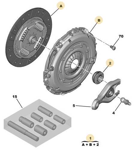

You actually have this engine and it's a 130.
DISPATCH III LONG PANEL VAN H1 TYPE 12 2.0 HDi 130 FAP (DW10CD) Manual gearbox 6
The OEM clutch is part number: 205316, £442.44
There is a Citroen Exchange Clutch kit, part number: 205809, £383.52
All inc. VAT and include 'A', 'B' & '2':
So if you search on 'Citroen 205316' or the other part, you should get a choice of others - a Valeo kit is about £300.

It looks a bit confusing as there are no less then 5 2.0 diesel variants!
Yours uses the same clutch as the 100BHP version and uses a conventional solid flywheel. All the others have DMFs and various clutch kits to suit. At least you are saved the hassle of a new DMF!!

Just a follow up in case its of use i changed the clutch this weekend took a day & a bit plodding thru without a ramp I lowered/chocked the subframe LHS down about 2 inches as suggested somewhere, this allows you to slide the box over into a bit of a gap (you can leave strut in place disconnect 2 bottom bolts from hub, remove driveshaft, disconnect tie rod) you'll need a clutch alighment tool or fabricate one i used 15mm copper pipe & some tape as you wont be able to do it by eye you can only slide the box away about a 'foot' but enough to get in and swap the disc/plate & bearing. An assistant might be of help getting the box back as you need one person underneath on the 'engine' side to line up the box onto the RHS driveshaft and one person to 'ump' the box back inwards. You're also pushing/dragging & resting the weight of the box on the subframe where 2 alloy aircon pipes are located these need to be protected as piercing one with yourself in close vicinity will cause a lot of distress
