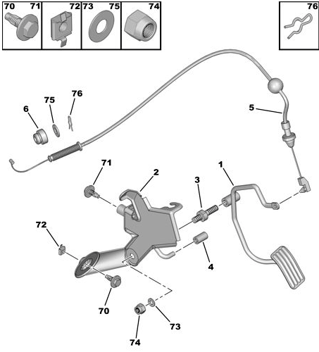

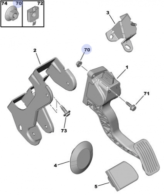

So you have a BERLINGO VU (M59) SHORT VAN '800' 1.4i 75 (TU3JP) Manual gearbox 5
This system has SAGEM injection ECU and system (not VDO). It was fitted with one of 2 systems for TPS - it will wither be contained in the accelerator pedal or it will have a mechanical linkage to the TPS in the engine bay:
I know some of these early ones suffered with ignition coil issues, but it really needs hooking up to Lexia to get some fault codes - any you do get may help us further.

Cable to TPS.
All parts clearly labeled VDO, Throttle Body, TPS.
