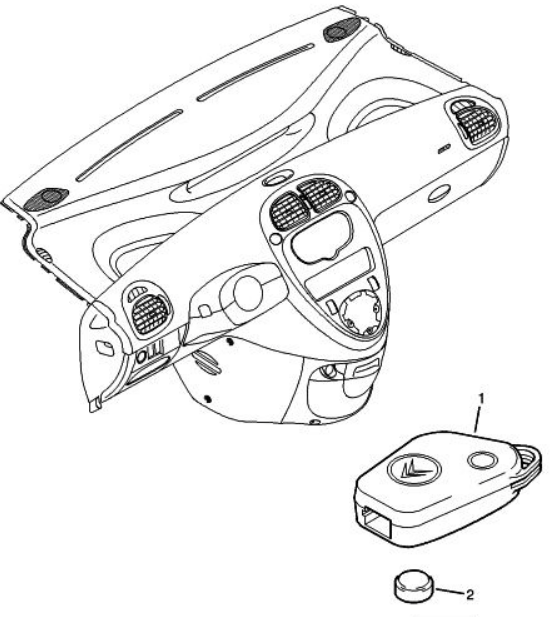

Re: Fob programming
Ok, so there are 2 types of fob for this year / model of your Xsara Picasso. You have the following type:
Citroen Part Number: 6490L8
Transponder: ID46 - PCF7936
Frequency: 433 Mhz
Be careful - and do not simply look for the fob design as that means nothing these days due to aftermarket suppliers copying parts.
What is important is that for your Picasso, which was built in March 2002 it that part number 6490L8 is used, as after 2002 they changed the car's electronic architecture and a new type of design was used with a different part number (6554RF).
So although the Transmitter frequency and transponder chips may be the same, the circuitry used to send the signals for the remote locking and other functions may not.
Here's a link to a supplier:
http://www.car-keys-online.com/product/ ... -2002.html
Frequency: 433 Mhz
| Official Fob Type | Similar Fob Types |
