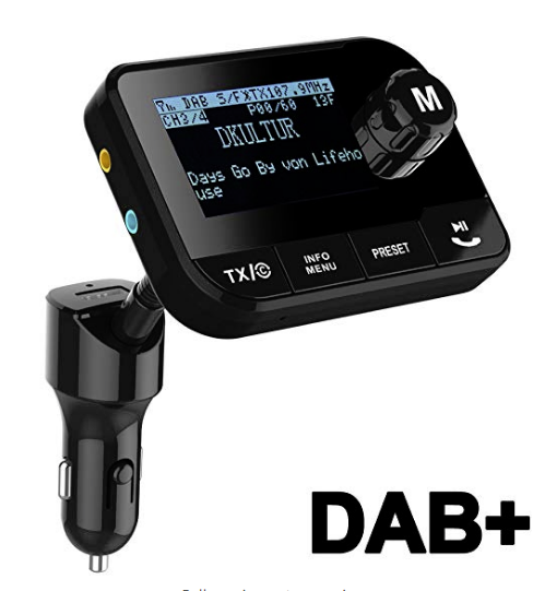

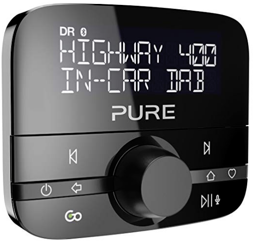

Here's the sort of thing I'm talking about that would give you DAB radio too:
Both these provide DAB radio and Bluetooth music - there are lots of variations and connection options.

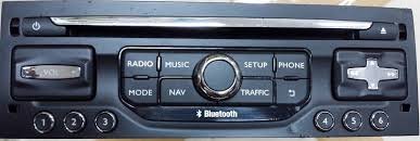

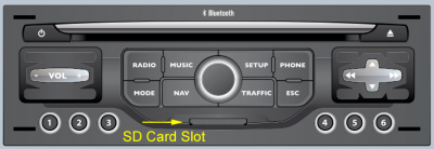

Hi Dani
The RT6 does look very similar, but the MyWay (RNEG) has an SD card Slot, whereas the eMyWay (RT6) does not.
Remember you will need to upgrade the colour screen to a DG4 Hi Res screen too.
