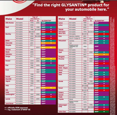

Even BASF, the makers of Glysantin, say that G30 is the right antifreeze for Citroens....
https://www.glysantin.de/sites/default/ ... ars_EN.pdf?
https://www.glysantin.de/en

G30 is only silicate free and from the spec, not B71 5110 compliant. There is coolant that more closely follows specs, or completely, so people should probably go for that.bobins wrote: 05 Dec 2018, 21:34 Even BASF, the makers of Glysantin, say that G30 is the right antifreeze for Citroens....
G30 seems to be sold only in concentrate form, whereas most DIYers should always used premixed to avoid issues.
