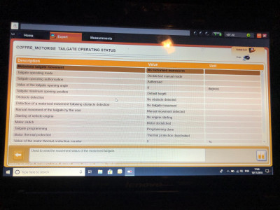

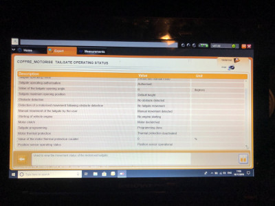

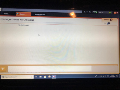

Trainman
- (Donor 2018)
- Posts: 2593
- Joined: 21 Aug 2009, 11:58
- x 43
Re: X7 electric tailgate
Tried the actuator test for the boot control, and it doesn’t unlock the boot, I also tried the buzzer test and that’s fine.
The red button on the tailgate isn’t lighting up, so I’m wondering if maybe the switch has failed? The tailgate comes half open using the fob and/or the exterior boot switch, but won’t close.
There are no fault codes showing of any kind
