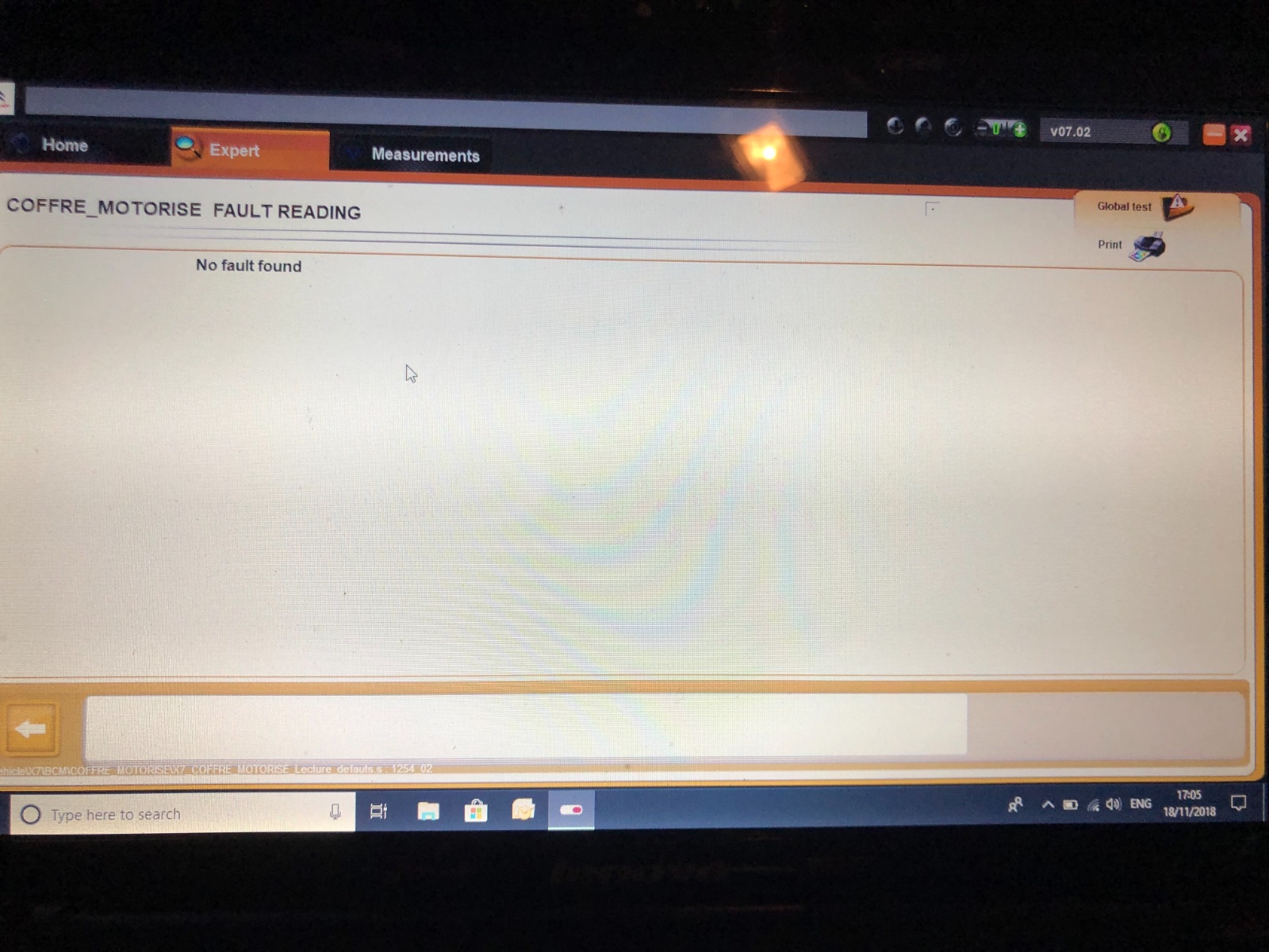

Unread post by Trainman »
No, no codes whatsoever, I’ve just noticed the switch on the tailgate (red one) isn’t lit, checked the fuse and that’s fine.....

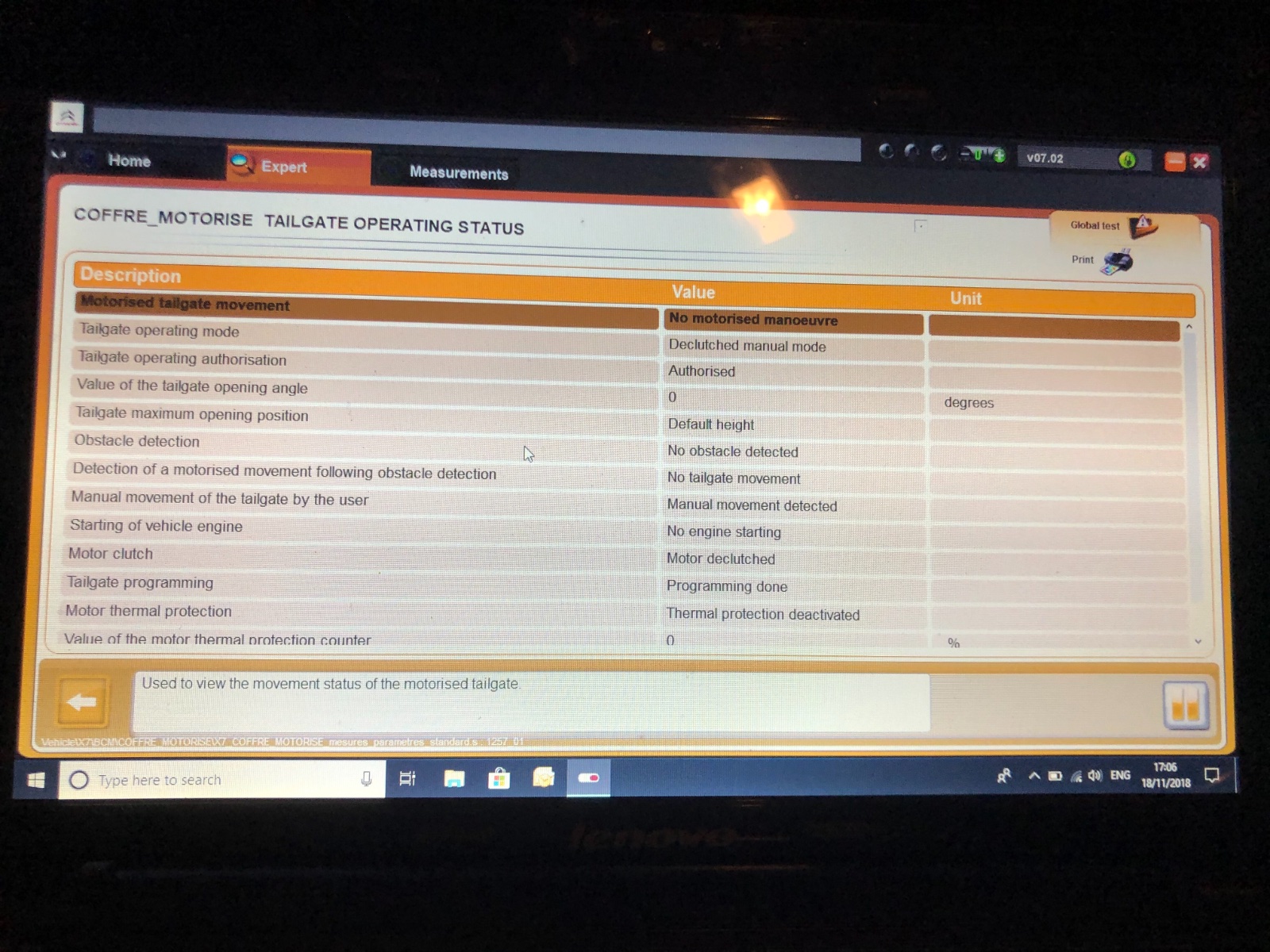

These are the Actuator tests you can perform Steve with Diagbox. Note the testing conditions and see if any of these work or don't in the absence of any codes:
TitleDetailsAssociated messageHELP
Control:
Motorised striker plate
1 cycle for opening/closingThis actuator test must preferably be done with the motorised tailgate open:
Observe the movements of opening and closing of the motorised striker plate
Lets you check the correct operation of the motorised striker plate
Control:
Motorised tailgate
1 cycle for opening/closingThe motorised tailgate should in the closed position:
Observe the opening and then the closing of the motorised tailgate
Lets you check the correct operation of the motorised tailgate in opening and then in closing
Control of the buzzer1 long beep + 1 absence of beep + 2 short beeps + 1 absence of beepListen to the beeps from the buzzerLets you check the correct operation of the buzzer for the motorised tailgate
Control:
Lighting of the motorised tailgate closing switch
2 cycles in 16s
(1 cycle = 1 lighting (5s) + 1 extinction (3s))
Check the 2 cycles for "lighting/extinction" of the motorised tailgate closing switchLets you check the correct operation of the lighting of the motorised tailgate closing switch
Control:
Clutch of the motor
1 clutch cycle (Boot closed, the clutch declutches automatically)This actuator test must preferably be done with the motorised tailgate closed. Listen to the clutch of the motorised tailgate, clutching and then declutchingLets you check the correct operation of the clutch of the motor of the motorised tailgate

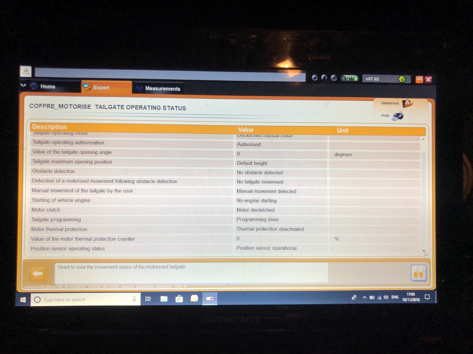

Tried the actuator test for the boot control, and it doesn’t unlock the boot, I also tried the buzzer test and that’s fine.
The red button on the tailgate isn’t lighting up, so I’m wondering if maybe the switch has failed? The tailgate comes half open using the fob and/or the exterior boot switch, but won’t close.
There are no fault codes showing of any kind
