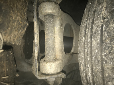

I had both wheels off the C5 today to inspect everything and replace the fluid in the power steering when I came across several concerning issues.
Both struts were wet at the top with LDS, now I have already replaced the driver's side strut in the last year so seeing oil at the top is crushing.
On the passenger's side in addition to the wet strut top, the gaiter appears to have detached from the bottom of the strut and ridden up the shiny ram surface. No amount of force I could muster was enough to move the gaiter back down to where it should go.
This video shows the issue:
I'm completely disheartened to be honest, especially seeing oil at the top of the recently replaced strut!
Has anyone ever seen this issue of a detached strut gaiter before? and if so, can anything be done about it?

Totally gutting to have this issue Elis. It will be interesting to see if anyone has any other ideas - as this would seem to be another Achilles heel of the X7 to go with the steering rack dilemma.
I think the MK I & II systems were much better in that it allowed for replacement seals and gaiters with the return pipes - but these X7 struts are the stupid bonded all in one types that would initially seem to have no repairability factor. The LDS is returned via the firmness regulator on these. I suspect a new strut may be the only answer - but with the newly replaced one I would really want to know whether this has failed or is just 'misting'.

Not going to lie, I’m properly pissed off. The suspension in this car is underwhelming in both smoothness and body roll and with terrible reliability too! I can maybe see why Citroen ditched hydractive in the end.
I’ve just been to the car and raised and lowered the suspension to see if the weight of the car would be enough to push the gaiter back down.
Unfortunately it hasn’t.
Here is the drivers side wheel at med-high settings, note the correct stretching of the gaiter corrugations:
Now here is the passengers side. Note how the gaiter corrugarions are still bunched up meaning that the bottom of the strut ram is exposed:
Also, notice how both are covered in oil at the top :evil:
