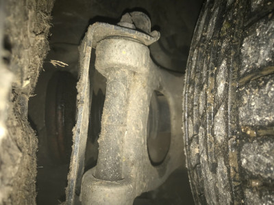

I had both wheels off the C5 today to inspect everything and replace the fluid in the power steering when I came across several concerning issues.
Both struts were wet at the top with LDS, now I have already replaced the driver's side strut in the last year so seeing oil at the top is crushing.
On the passenger's side in addition to the wet strut top, the gaiter appears to have detached from the bottom of the strut and ridden up the shiny ram surface. No amount of force I could muster was enough to move the gaiter back down to where it should go.
This video shows the issue:
I'm completely disheartened to be honest, especially seeing oil at the top of the recently replaced strut!
Has anyone ever seen this issue of a detached strut gaiter before? and if so, can anything be done about it?

I’ve just been to the car and raised and lowered the suspension to see if the weight of the car would be enough to push the gaiter back down.
Unfortunately it hasn’t.
Here is the drivers side wheel at med-high settings, note the correct stretching of the gaiter corrugations:
Now here is the passengers side. Note how the gaiter corrugarions are still bunched up meaning that the bottom of the strut ram is exposed:
Also, notice how both are covered in oil at the top :evil:

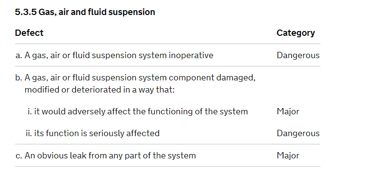

Thanks Marc, just had a look at that document. In section 5.3.4 it says that a missing dust cover or one that no longer prevents the ingress of dirt is a major fail. However that is under the section pertaining to suspension joints, pins and bushes. I'm not sure if the strut itself would be covered by that definition.
The section specifically relating to fluid suspensions is more likely to cause issues:
So any deterioration where the function is adversely affected would me a major fail? That seems very broad and would cover every issue with the system?

That's the bit that concerned me - although not in the 5.3.5 bit it is still there so that's the cloudy area I was referring to.....
