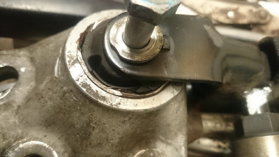

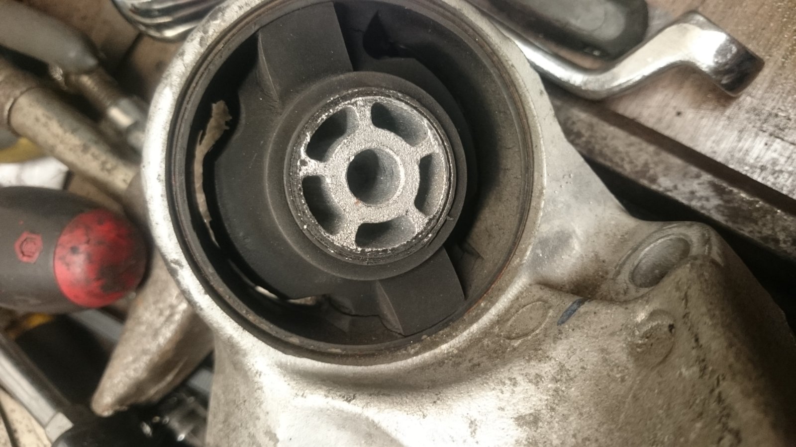

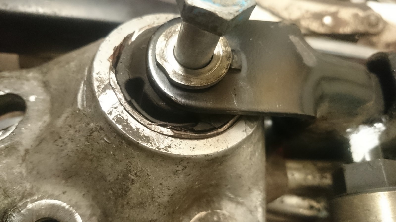

I know that you got a massive knowledge and plenty workshop manuals so hopefully will be able to help me on this one. Engine doing some sharp movements during sudden acceleration and when pedal is released. I was told that engine mounts need to be replaced. I saw a broken bush on top mount but pretty sure that not only reason for that issue. How the other mount looks like ? I'm guessing that they not the same as in 90bhp model ? I'm looking for any other place where I can source the parts, because quote from Citroen dealership was almost equal to a value of car :roll:

The mounts are slightly different on the 110 to the 90. The most likely cause of the engine rocking is failure of the torque link on the inner wing. See this thread: viewtopic.php?t=49891 Hopefully yours is not as bad as mine was!! The bit looks to be available still, but has now crept up to around £40. The bush is not available separately from Citroen, but I expect it could be replaced with a poly bush if necessary.
Engine mount diagram:
The inner wing link is item 1. The others that might be a cause of rocking are 11 or 26, which also appear to be available, at £35 each.

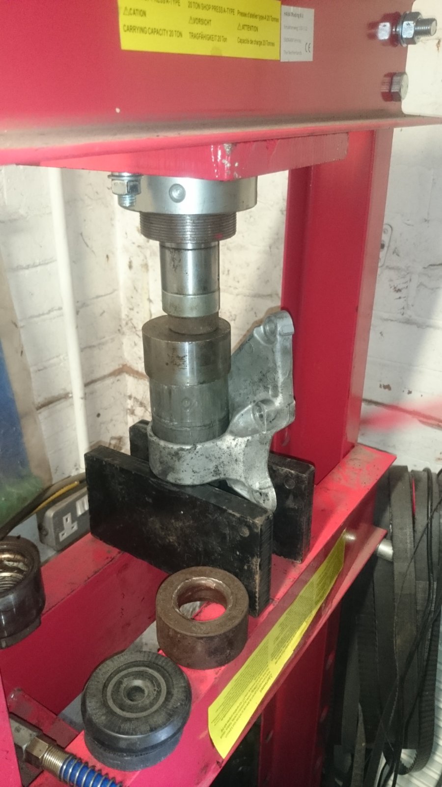

Hi 26 is available from Powerflex as a poly bush press old one out then push two parts back in yourself and probably same as other one 11?
Takes a few mins to press old ones out what they mean is there sh!te and don't have the equipement
Friend was saying you can get a DIY bush presser/driver that does it with bolt and cups?

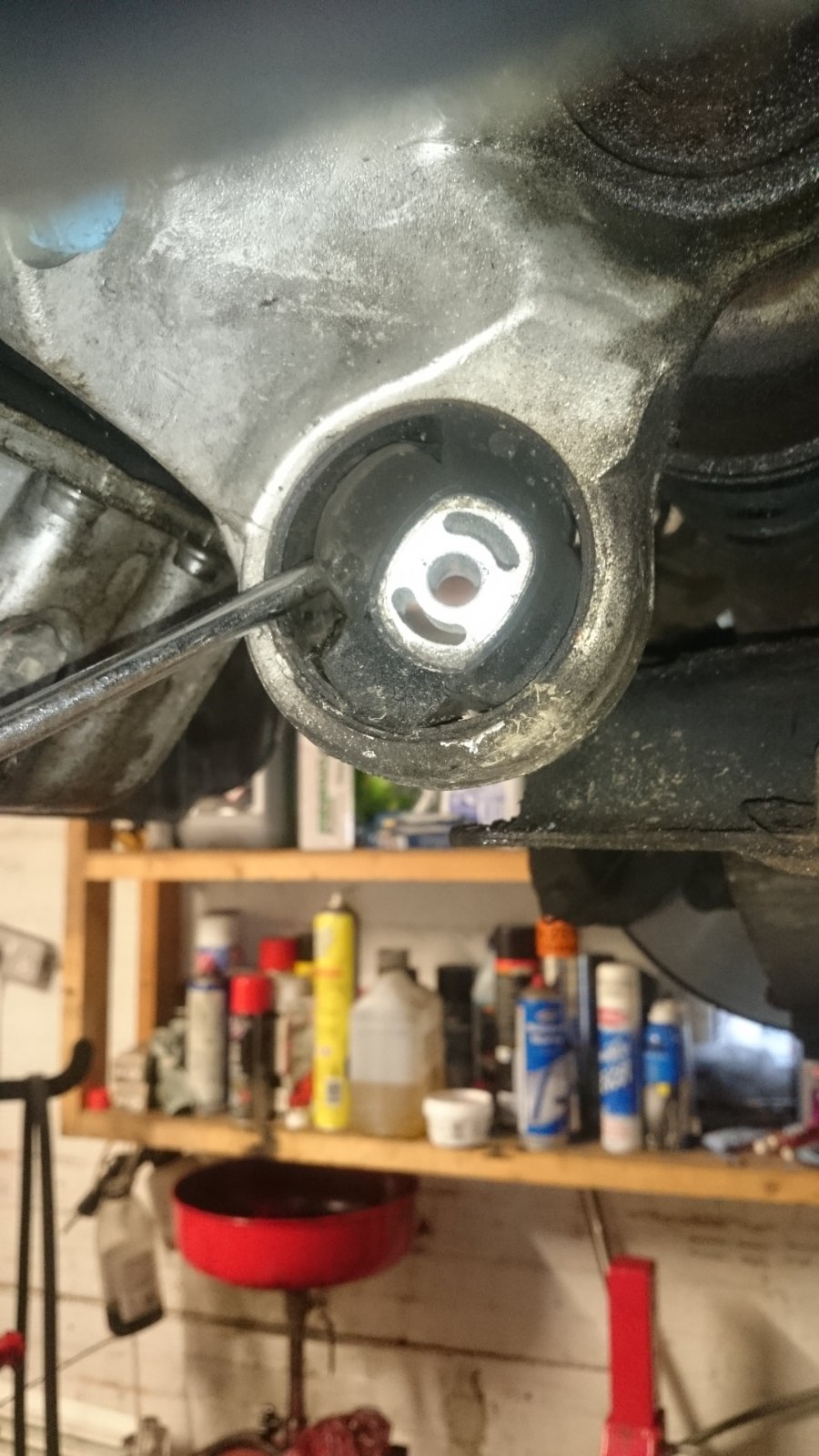

I got the all from Citroen in Chester. Found a guy which will do both bushes for £30 so that sorted. At same time will do timing belt and few other bits and bobs :)

OK, on job done - massive improvement. Thanks for advice guys !
