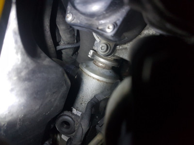

Since my last post I have decided my car problems on my C4 grand picasso are EGR related. I am planning on removing my EGR valve at the weekend to give it a clean up. I have had a dry run already so know how to get to it. I have even undone the two bolts that hold it to the block. The only problem I can see is unclipping the exhaust clamp and then getting the clip back in place when I reinstall the EGR valve. Is there any special tool or technique I need?
It is very limited space and I undid the bolts by feel as I cannot see the valve. I managed to get my phone in position to take a photo (attached).
Would it be better if I removed the windscreen wiper panel? Any advice would be great.

Remove scuttle under windscreen helps a lot. The clips are a pain I’ve spent more time replacing that clip then changing EGR valve. Sometimes when you buy a new EGR they come with a new clip. There is a special tool required for said clip.

Remove the battery (possibly the tray as well), air pipes, fuel filter and bracket, wipers and scuttle, air box, and possibly the cabin air duct (I think it just pulls off). Access is then not bad to the EGR. To get the clip off you need a pair of Clic pliers. In theory you can refit the old clip, but Citroen supply a repair clip that is bolt up. Mind you fitting that is not all that easy! You should get a new gasket as well - it's very easy to drop the old one...

Regarding the clip, insert a small flat bladed screwdriver where it clips together and twist, to refit, use a pair of nail removing pincers (nail as in hammer and nail), these will reclip the tang, then strike the clipped tang, takes seconds.
