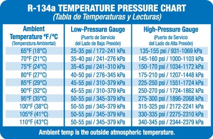

But as you can see the temperature in the high pressure circuit can indeed reach such high pressures depending on ambient temp which can impact the cooling efficiency:

yes but I did qualify the definition in a later post James. That was PSA terminology, don’t shoot the messenger. 🔫
