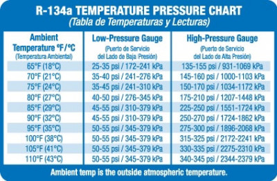

Re: How hot is too hot? [DW10ATED MK1 C5]
But as you can see the temperature in the high pressure circuit can indeed reach such high pressures depending on ambient temp which can impact the cooling efficiency:
