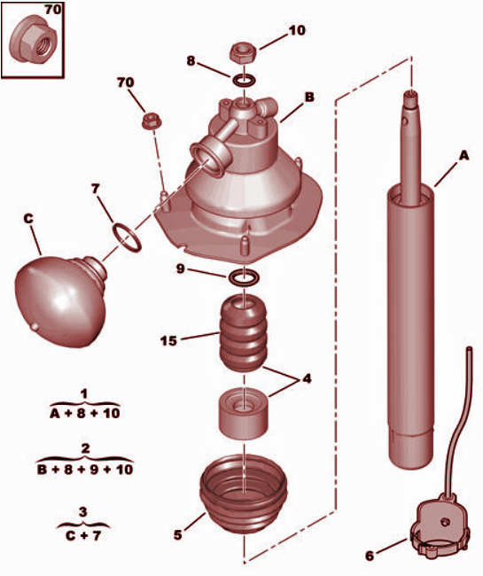

Check the strut mounts, see if there is any movement if somebody turns the wheel lock to lock at the top of the mount inside the engine bay where the suspension sphere connects to the strut top / mount.

The strut should be anchored by the mount at the top and the lower arm at the bottom. Which end has a wobble?

Going into the socket at the top.

Here's the parts for the sphere / strut Mount - can you be a bit more descriptive of the issue? 'B' is the strut mount - so is this loose or turning?
