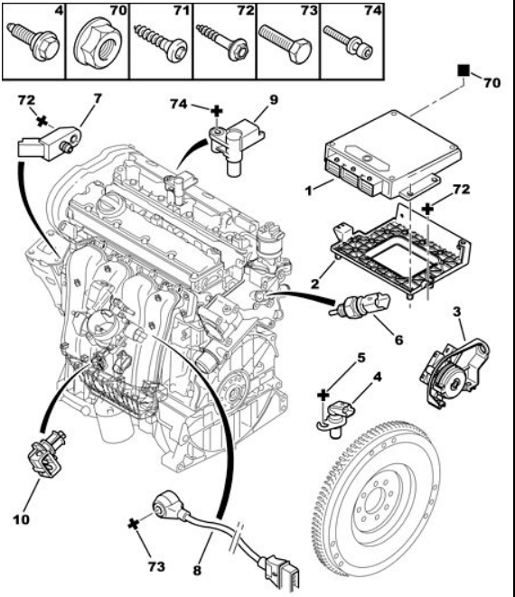

Re: C5 Petrol - Engine Starting Wiring Issue
So are you saying you had a new injection ECU ordered - like item number 1 in the diagram?femtiolappen wrote: 02 Oct 2018, 12:19 Yes I have ask , car not start when cool outside , have to use a hairdrayer for start the car.
This is exactly the same problem like I have
viewtopic.php?f=3&t=50336&p=559818&hili ... an#p559818
I want to go around the problem , The ecu is new from citroën it cost 1500euro , but same s**t it not start when cold. Summer it working fine but 10 and down it will not start without heat.

Yes no1 new from France replaced by Citroën , if the car stay in a hot garage the Lexia can connect to the ECU but if the car stay cool it can not connect and Lexia says ECU is looked , immobilizer fault and esp not working.
I not heating on the ecu beacouse it not help , I heat the main cablage if it -20 it take about 30min if it 6 it take about 5min , I have check all GROUND connections. I have open the cablage to but not se something.
When turn ignition on the yellow engine symbol not ligts up , only when i make cablage hot the symbol start light , then I can start the car.
Maybe I can make a 12v wire to that lamp? So 12v comes backway to ecu.
