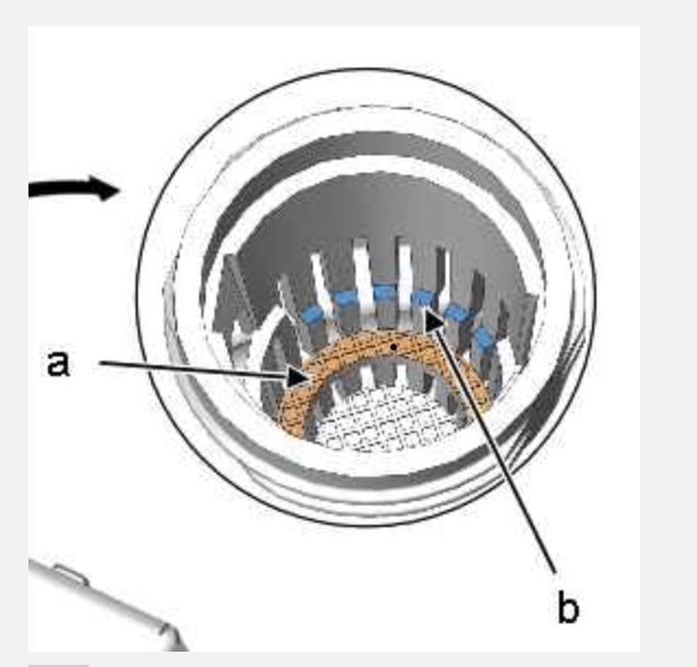

Check the LDS fluid level.
Put the car on flat ground, engine running, put suspension to lowest setting and check LDS fluid levels are between the A and B marks:

Re: C5 2.0 hdi 55 reg power steering problem
It’s contains both the suspension and the power steeering fluid. The systems share the same fluid reservoir. The fluid is called LDS and is exclusively used in the Citroen C5 and C6 hydraulic suspension systems and in the Power Steering systems of many Peugeot and Citroen vehicles.
As I said, check the fluid levels according to my last post. The breakdown companies very probably don’t have the knowledge of how to check these systems correctly for fluid levels.
Sometimes raising the car through all height settings and lowering a few times at standstill is good to keep the hydraulics excercised.
Ok, just keep an eye on things - never overfill the tank - and ensure it's checked on the lowest suspension setting. It may have just been a glitch.
