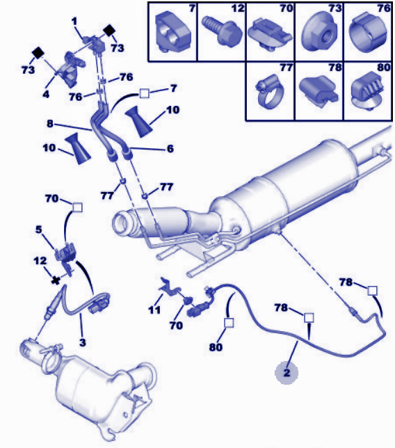

So on the basis of this code alone, it would seem your gas temp sensor is either faulty, or the electrical connections are. I will need your VIN to confirm this, as there's only so far the crystal ball can see. :-D
If it is the sensor that is faulty, here is all the info you need (pending VIN for confirmation)
Item 2 on the Diagram
Part No: 1618KP
Price £127.14 inc. VAT from Citroen

10051550 wrote: 23 Sep 2018, 15:51 Hmm can’t seem to post vin sorry , will check with dealer thanks again
Yes correct parts as per my diagram - confirmed with your VIN.
