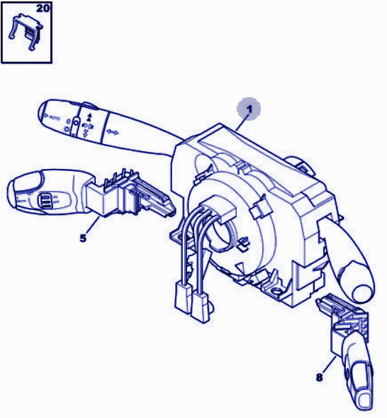

It will only need calibration with diagnostics if the car is equipped with ESP, if the car has ESP there will be a deactivation switch on the dash above the radio. There is also an extra electrical connector on the comms unit that is blue on ESP models.Memphis wrote: 16 Feb 2023, 13:33
looking at the fuse box in the engine bay I've got the board that means the lights are controlled by the comm2000 unit, how do i check which unit is compatible with my model? (others have stated that the models on ebay may not be compatible) and how do i check if it has to be calibrated?
If it doesent have ESP then its a straight swap, no programming needed.
If going down the used route just match up the spec.
With or without ESP is the most important part to match up
with or without auto lights & wipers.
With or without rear wiper.
with or without button for trip computer.
With or without front fog lamps (not that important as the front fogs will still work even if you get one from a model without)
The radio controls & cruise control (if fitted) stalks are seperate parts & you just swap them over from your old unit.
