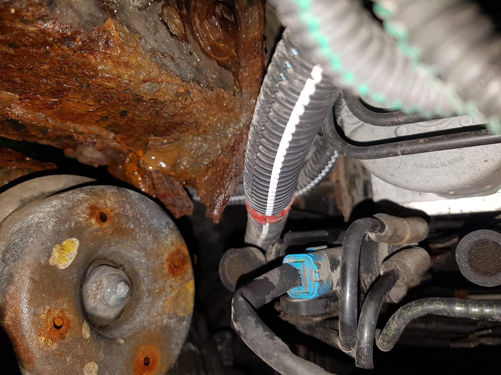

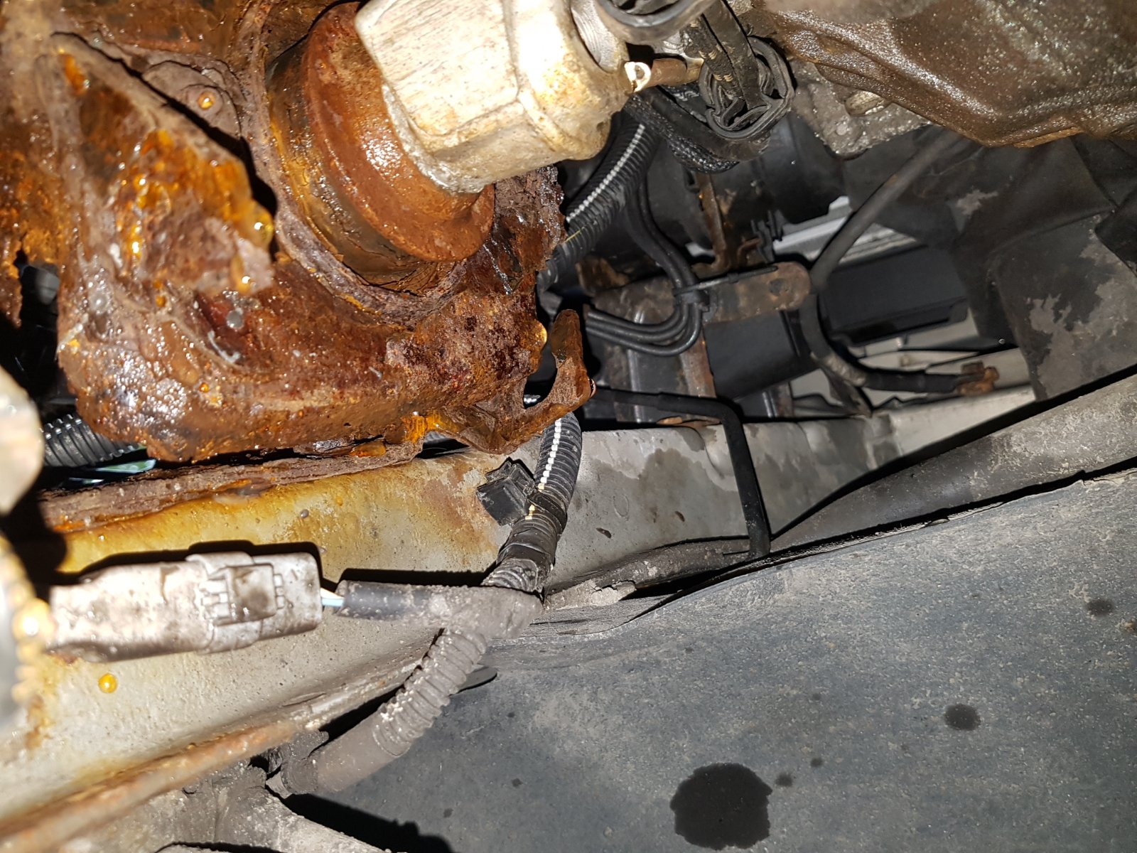

The left engine/gearbox mounting bracket on my 2004 C8 2.0 Hdi has rusted off, and as a result the engine and gearbox assembly has dropped down quite a bit on the left side. I have been trying to source this bracket online, searching with various phrases, but with no luck. I am not looking for the rubber mount, but the bracket that goes between the rubber mount and the body. Google isn't even able to show me a photo af this "secret" bracket. Would anyone have a part number for it? There are plenty of used parts for the C8 on ebay, so I find it a bit strange that this bracket isn't there. By the way my car has the 4 speed automatic transmission, not sure if the bracket would be different on a car with manual transmission...

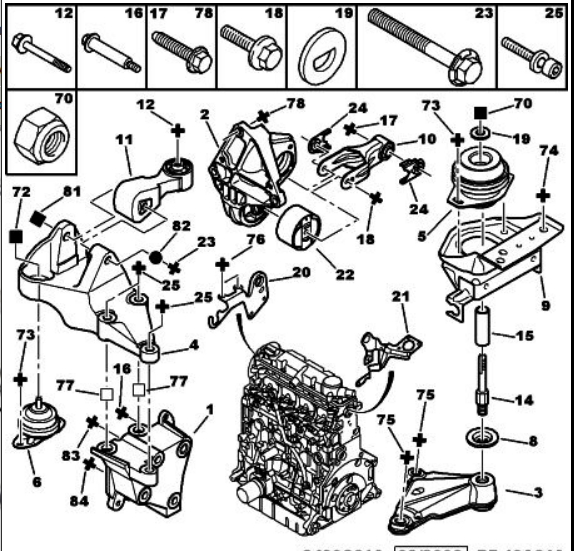

Ok, so here is the parts diagram:
Click to Zoom The elastic part (number 5 on the diagram) is still available from Citroen at £68.21 inc. VAT - and would seem to incorporate the whole thing if that is the part you are referring to. If it's not number 5, let me know which item it is.
- Posts: 11008
- Joined: 09 Nov 2005, 22:03
- x 1476
Re: C8 left Engine/gearbox mounting bracket
I think it is item 9 he is after.
- x 6948
If it's number 9 - that's the Engine Mounting Bracket, part number 1813H0 and is still available from Citroen for £23.38 Inc. VAT.

It's number 9 I'm looking for. Thanks!

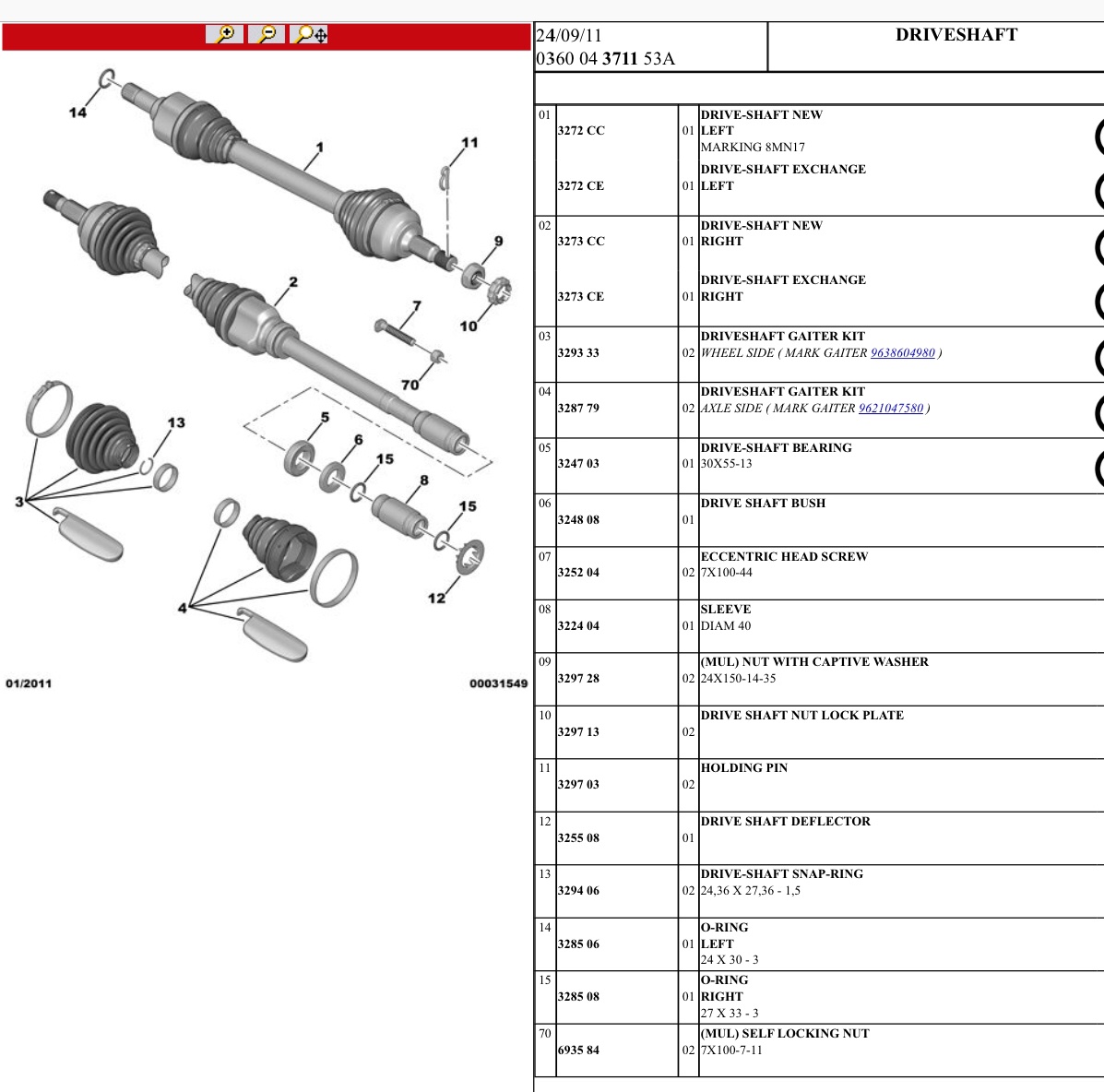

When the engine/transmission fell down, it resulted in the inner joint of the driveshaft coming apart, the driveshaft was damaged, and I cut it off with an angle grinder to be able to tow the car home. So I am looking for a complete left driveshaft as well. Would you have a number for that one too? From what I've heard it's different on manuals and automatics. Mine has the 4 speed automatic.

I have your VIN so have all the details I need.
Citroen offer a new and an exchange part. In both cases there is a refundable deposit on return if the old one. But at least you have the part numbers. These are for the left driveshaft.
Part 3272CC for the new one £428.08 inc. VAT
Part 3272CE for the exchange one £227.59 inc. VAT
£66.96 is the deposit on top of this.
Click to Zoom
