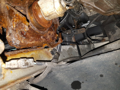

The left engine/gearbox mounting bracket on my 2004 C8 2.0 Hdi has rusted off, and as a result the engine and gearbox assembly has dropped down quite a bit on the left side. I have been trying to source this bracket online, searching with various phrases, but with no luck. I am not looking for the rubber mount, but the bracket that goes between the rubber mount and the body. Google isn't even able to show me a photo af this "secret" bracket. Would anyone have a part number for it? There are plenty of used parts for the C8 on ebay, so I find it a bit strange that this bracket isn't there. By the way my car has the 4 speed automatic transmission, not sure if the bracket would be different on a car with manual transmission...

It's number 9 I'm looking for. Thanks!
When the engine/transmission fell down, it resulted in the inner joint of the driveshaft coming apart, the driveshaft was damaged, and I cut it off with an angle grinder to be able to tow the car home. So I am looking for a complete left driveshaft as well. Would you have a number for that one too? From what I've heard it's different on manuals and automatics. Mine has the 4 speed automatic.
