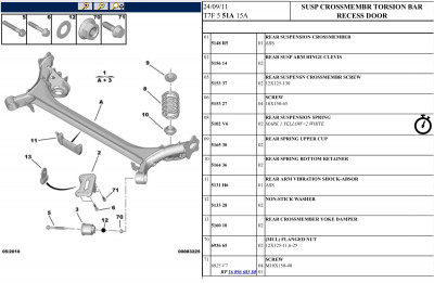

Another query regarding my 308 cc is the knock I hear from the rear nearside of the car.
I first heard it when I dropped the roof down and it was quite pronounced and as I couldn’t hear it when the roof was back up I thought it might be the way the roof folded and was hitting something in the boot area but I now think it might be something suspension having had a similar knock on my 350Z last year which was one of the suspension arm bushes.
If anyone has had a similar problem or knows if any of the bushes are prone to failure I’d appreciate any help.
Also does anyone know what the two dumbbell type items are attached to the rear each end? They just look like counterweights to me.
Certainly if there are any help topics that can give a good idea as to which bushes would benefit from being upgraded to help the ride and cornering that would be good too.

- x 6963
Re: 308 Knocking from nearside rear of car
Ok so you have the 308 COUPE CABRIOLET - 2 DOOR 1.6 THP 16v 150 Manual gearbox 6
Thanks Marc
Very helpful diagrams.

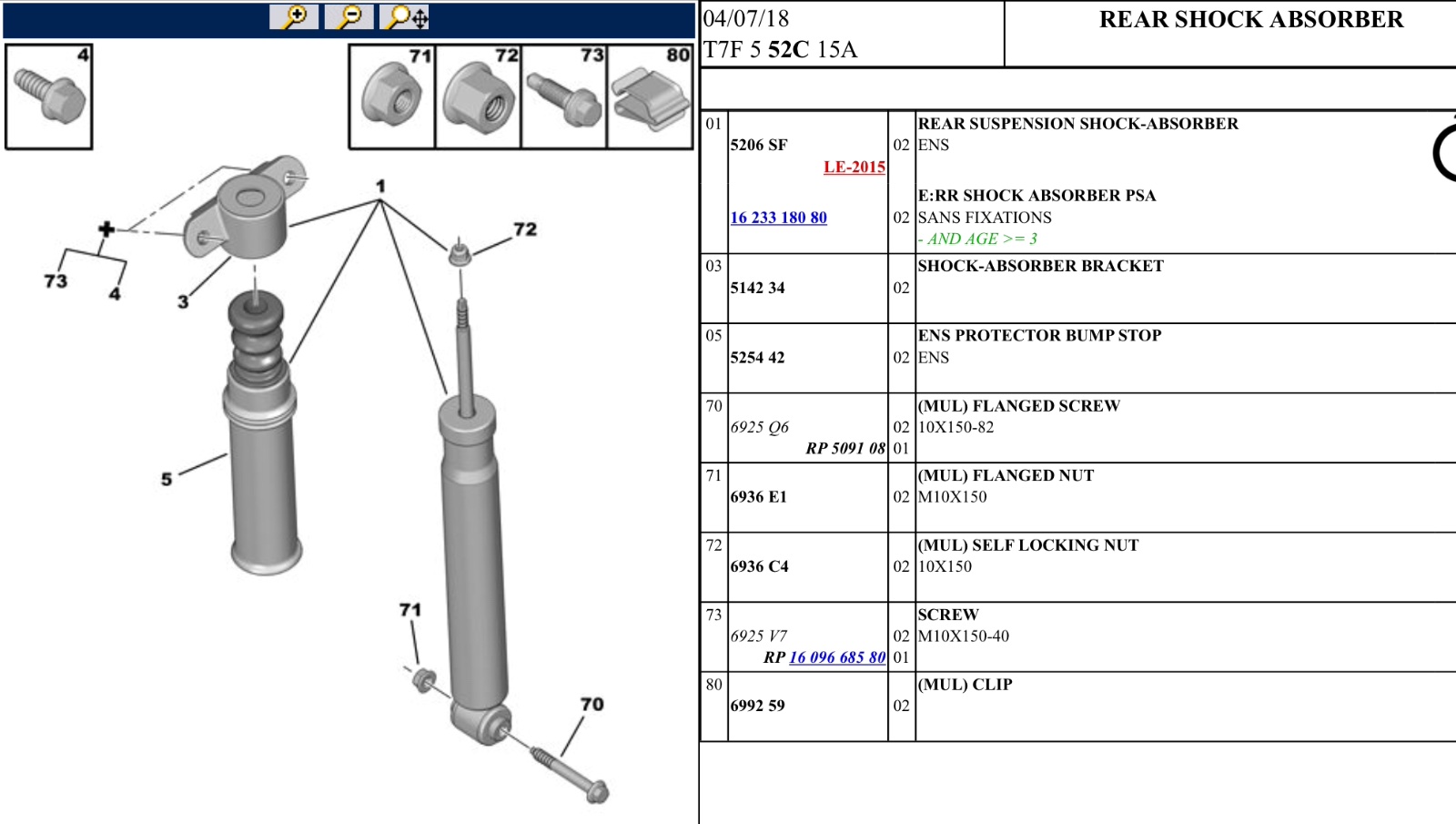

GiveMeABreak wrote: 11 Sep 2018, 21:23 Ok so you have the 308 COUPE CABRIOLET - 2 DOOR 1.6 THP 16v 150 Manual gearbox 6
74F2B7E1-D7D6-4B07-9E82-BEC66CA41246.jpeg 099AB00C-C86A-49E3-942F-94050BE56592.jpeg
Yep, looks the same. Item 3 - it's got a rubberised bush inside, as the mount gets eaten away the bush starts to move about. One of mine the top of the mount disappeared completely allowing the damper shaft to flop and bang about really loudly! In theory, you can fit a new mount, but the nut on the top of the damper was just a rusty mess on mine, no way it was going to come apart; I just fitted a new damper complete from a breakers; you might not want to do that if you are worried about 10/10ths handling!!
