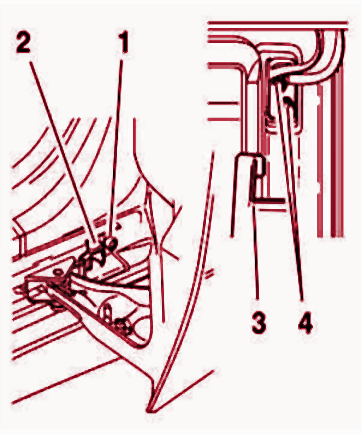

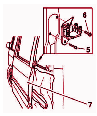

Removing
  • Lower the glass approximately two thirds of its travel.
  • Protect the rear wing.
  • Support the door on the stands [1].
Remove:
  • The fixing (1)
  • The stop (2)
  • The trim (3)
  • The mountings (4) (Take the weight of the sliding door)
  • Remove the mountings (5) - (6) (Take the weight of the sliding door).
  • Detach the bottom runner assembly.
  • Remove the sliding door (Two operators are necessary)

  • Tighten the fastener ( 1) to 1 daN.m..
  • Tighten the fixings ( 4) to 1 mdaN.
  • Tighten the fixings ( 5) - (6) to 2.4 mdaN.
