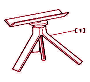

Here you go.
You'll need one of these:
Door Support Tool
Removing
  • Lower the glass approximately two thirds of its travel.
  • Protect the rear wing.
  • Support the door on the stands [1].

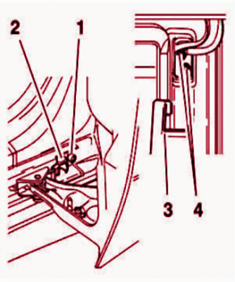

Remove:
  • The fixing (1)
  • The stop (2)
  • The trim (3)
  • The mountings (4) (Take the weight of the sliding door)
  • Remove the mountings (5) - (6) (Take the weight of the sliding door).
  • Detach the bottom runner assembly.
  • Remove the sliding door (Two operators are necessary)
