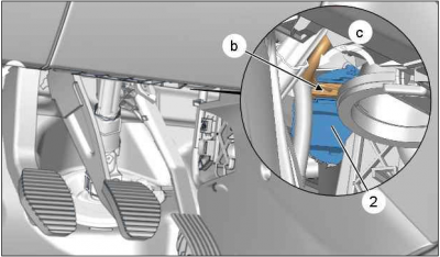

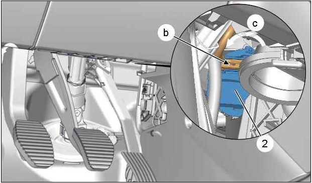

The pollen filter change won't affect the blower. The only thing you may have done is dislodged some of the wiring near the pollen filter.
There is a blower motor control unit located near the pollen filter that you may have moved that could of caused this.

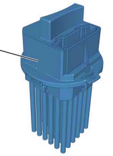

| Blower Motor Control Unit | Location of Blower Control Unit |

Thanks for reply. Tried but nothing happened the blower motor looks fine. Still running and i can’t turn off. Any other ideas?

The blower motor control unit is probably faulty then. They do fail and this is one of the symptoms. I would suspect this over the control panel to be honest. Do you have access to Diagbox for a test to see what, if any fault codes are showing?

The motor has the speed controller built-in which can fail.

Yes I should of said Blower Motor Control Module again Paul, that’s what I was talking about as I was carrying on from my previous post showing the module in the diagrams. On the X7 they are separate to the Motor unit itself, unlike the Xsara Picasso and others of that era that had the resistor units on the motor on some models.Paul-R wrote: 29 Aug 2018, 20:32GiveMeABreak wrote: 29 Aug 2018, 20:07The blower motor is probably faulty then. They do fail and this is one of the symptoms.
