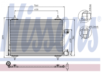

6455 FX is the part number Pete or 1610161080 for an 'economy' one!
The 'Core' measurements should be the same as per this diagram (430) from pole to pole - it's just the rad width and length and the fixing heights, so I would measure your old one as per the diagram to see which one you have - there is nothing in the docs I can find - unless Alasdair is still sifting...

Cheers Marc, it was the different width measurements that confused. I would also like to give a big thanks Citroen PATRY in La Chatre that didn't charge me for the above, and he knows I do my own work so he's not hunting for business. NOT a main Stealer, if it hadn't had a leak, they wanted 61 euros for a full regas compared to Peugeot who wanted 100 and the cheapest at 50 is a French version of Quickfit. When it's sorted I'll be back to the main dealer! The parts ordering is superb as well, and they've got a beautiful cx25 gti turbo in the showroom. (POTD)

No probs, but do measure yours Pete as per the diagram, at least you know what they are measuring against now. There are at least 4-5 measurement differences across the different brands. so I can only assume some are not designed to the same specs and they have just used the OEM part number regardless. It’s the major pitfall with these aftermarket suppliers....
