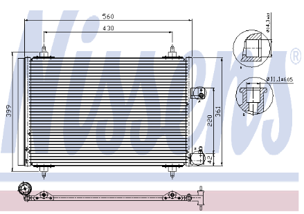

6455 FX is the part number Pete or 1610161080 for an 'economy' one!
The 'Core' measurements should be the same as per this diagram (430) from pole to pole - it's just the rad width and length and the fixing heights, so I would measure your old one as per the diagram to see which one you have - there is nothing in the docs I can find - unless Alasdair is still sifting...

Re: 407 condenser
Cheers Marc, it was the different width measurements that confused. I would also like to give a big thanks Citroen PATRY in La Chatre that didn't charge me for the above, and he knows I do my own work so he's not hunting for business. NOT a main Stealer, if it hadn't had a leak, they wanted 61 euros for a full regas compared to Peugeot who wanted 100 and the cheapest at 50 is a French version of Quickfit. When it's sorted I'll be back to the main dealer! The parts ordering is superb as well, and they've got a beautiful cx25 gti turbo in the showroom. (POTD)
Pete
- x 6950
Re: 407 condenser
No probs, but do measure yours Pete as per the diagram, at least you know what they are measuring against now. There are at least 4-5 measurement differences across the different brands. so I can only assume some are not designed to the same specs and they have just used the OEM part number regardless. It’s the major pitfall with these aftermarket suppliers....
