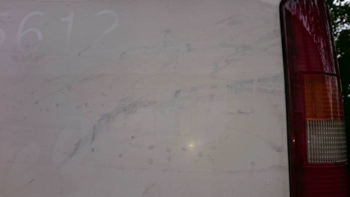

The stains in question
I backed right into a blackberry bush on Sunday (today being Tuesday) and noticed this yesterday. Tried to clean it off today and most of it came off but I'm left with these purple streaks that won't come off. I assume it's soaked into the paint.
Been to one of those East European car wash places and they said they couldn't get it off. I don't really want to scratch the paintwork to remove it. Can I de-stain it somehow?

I think that's why paint protection and a regular wax is a must - I've just noticed a mass of scratches on one of my lower door areas - and very likely brambles from the country lanes. I used Mantis scratch remover, that very gently polishes the scratches out - but in your case, I would think the dye of the blackberries has been absorbed into the clearcoat / or paint topcoat depending on your finish.
Not sure if this works, but dug it up - measurements are American, but I've added the equivalents.
  1. Pour 1/4 cup (2oz or 59 ml) of water into a bowl, with 1/4 cup (2oz or 59 ml) of white vinegar. The vinegar will cut through the berry stains, while the diluted mixture will prevent the vinegar from damaging the car paint.
  2. Pour 1 tsp. of dish soap into the bowl also, which will help cut through the berry texture.
  3. Dip a cloth into the solution, then wipe over the stained area of car paint. Wipe in small circular motions, as you would to buff out the stain.
  4. Continue until you have removed the entire stain, then clean the area once more with fresh, clean water. This will remove any remaining vinegar or berry residue.

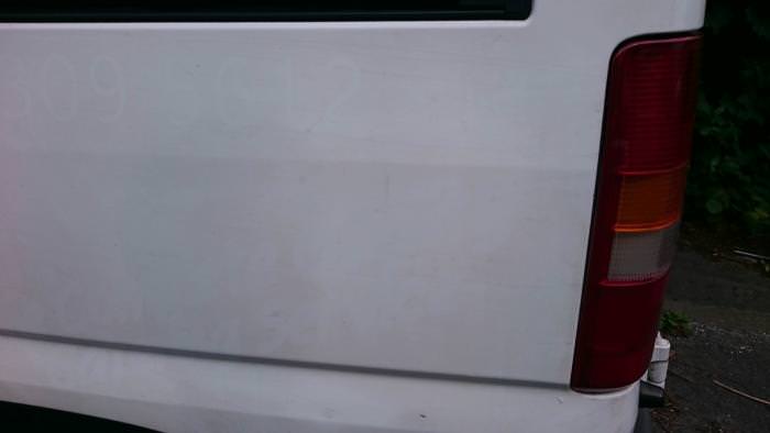

So I gave this a go last night. Wiped it on, rubbed it in and saw no improvement. Left it to soak for like 10 minutes and had another go. Nothing. Rinsed it all off and resigned myself to having stains.
Then I looked at it today, and it's all gone!
Woohoo

The paint is obviously porous: it took up the stain, and also that stain remover.
Quite common for cars painted in White not be be lacquered (at least no lacquer to peel!), and so no additional protective layer.
If it's completely gone, best to follow the advice and get some protective wax polish on the car.
