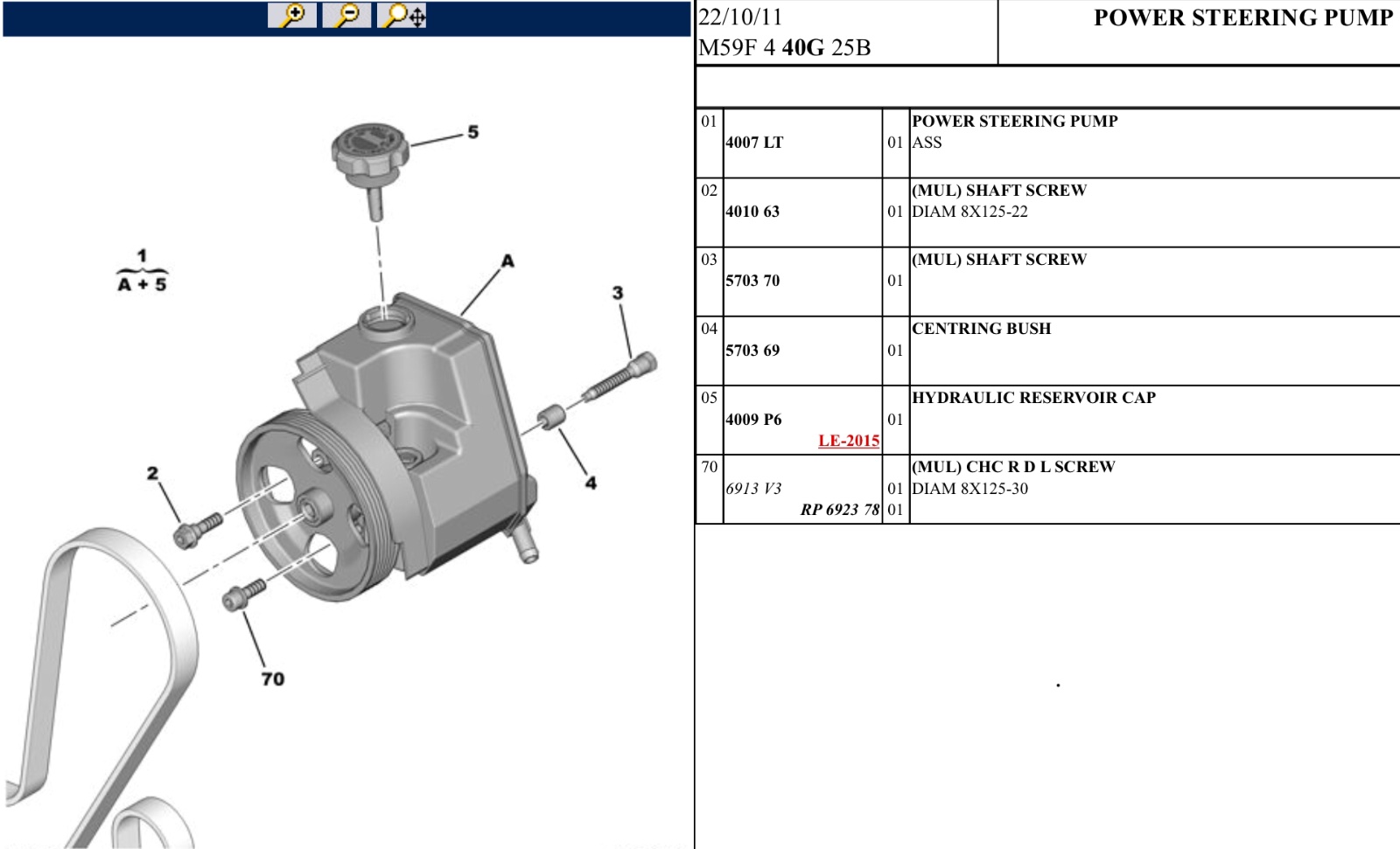

Ok, so here’s the part for the original Power Steering pump (4007 LT):

GiveMeABreak wrote: 30 Jul 2018, 22:59 Ok, so here’s the part for the original Power Steering pump (4007 LT):
Thank you! Pretty basic eh? Is there anything in the circuit that could cause it to fail..? Or am I just having really bad luck with 2 pumps failing me in a row?
- x 6963
Re: Power steering pumps keep failing - Peugeot Partner Combi 2005 2.0 HDI
Only that the original pump costs £412.48 inc VAT from the dealer!
I’m all for getting a decent aftermarket pump, but it has to at least work
. Some of those aftermarket pumps are from £92, and unheard of makes... So assuming you have filled it correctly and bled the system, if the belt is turning but the pump isn’t working then I would have to suggest it is substandard and not up to the job.
