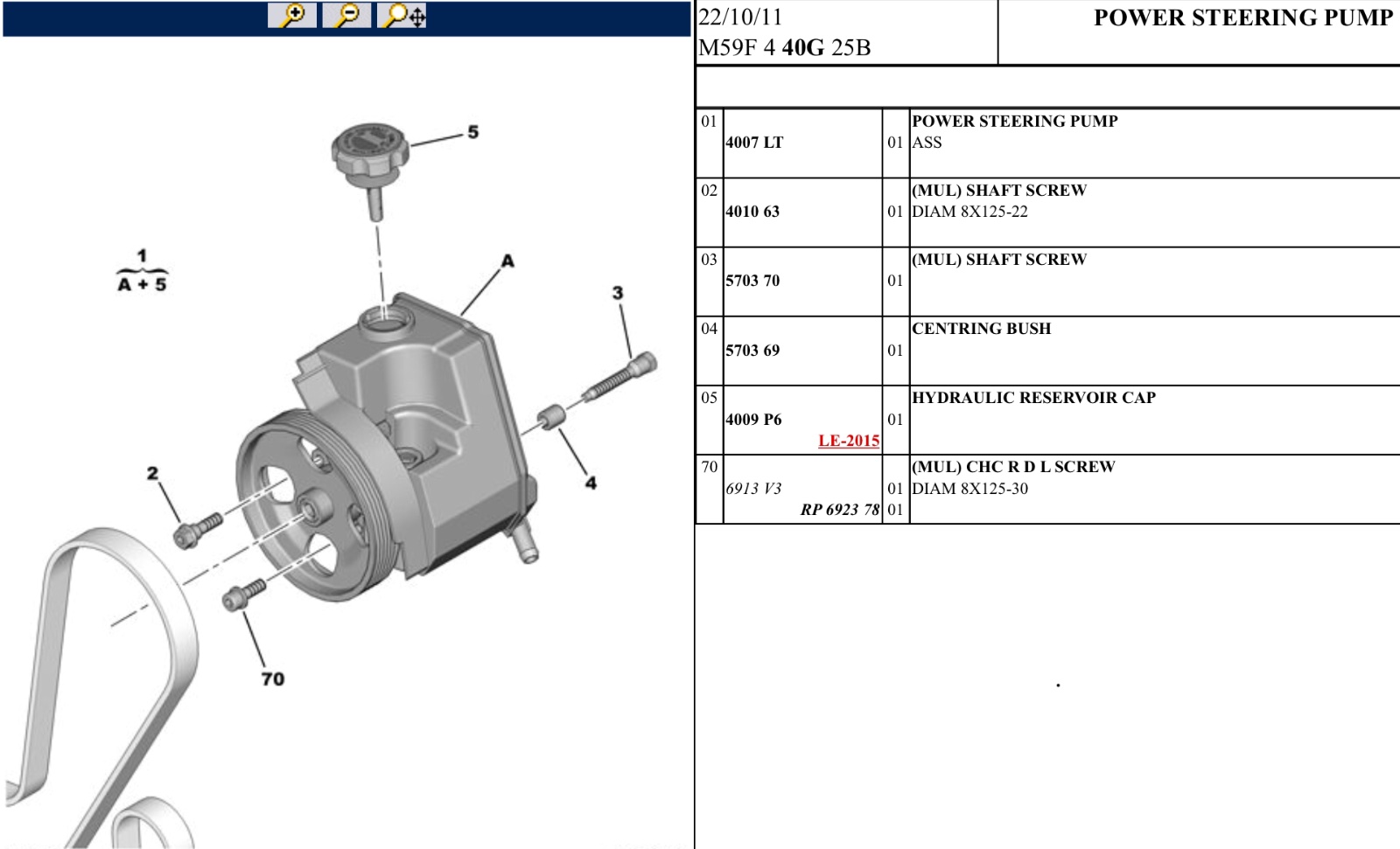

Ok, so here’s the part for the original Power Steering pump (4007 LT):

GiveMeABreak wrote: 30 Jul 2018, 22:59 Ok, so here’s the part for the original Power Steering pump (4007 LT):
Thank you! Pretty basic eh? Is there anything in the circuit that could cause it to fail..? Or am I just having really bad luck with 2 pumps failing me in a row?

Re: Power steering pumps keep failing - Peugeot Partner Combi 2005 2.0 HDI
Only that the original pump costs £412.48 inc VAT from the dealer!
I’m all for getting a decent aftermarket pump, but it has to at least work
. Some of those aftermarket pumps are from £92, and unheard of makes... So assuming you have filled it correctly and bled the system, if the belt is turning but the pump isn’t working then I would have to suggest it is substandard and not up to the job.

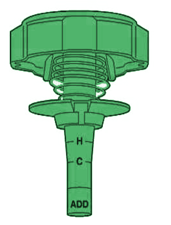

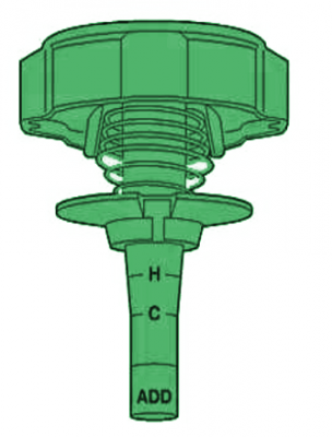

Fluid is TOTAL AT42
Bleeding procedure:
Bleeding procedure:
- Top up the power steering reservoir level to the mark ( c ) on the cap.
- With the engine not running, turn the steering slowly from lock to lock in both directions ( Approximately 10 times) .
- Run the engine at idle for 2 to 3 minutes without moving the steering wheel.
- Bleed the circuit by turning the steering several times in each direction.
- Keep the fluid level topped up.
- (H): Maximum level ( Hot) .
- (C): Maximum level ( Cold).
- (ADD): Level minimum.
