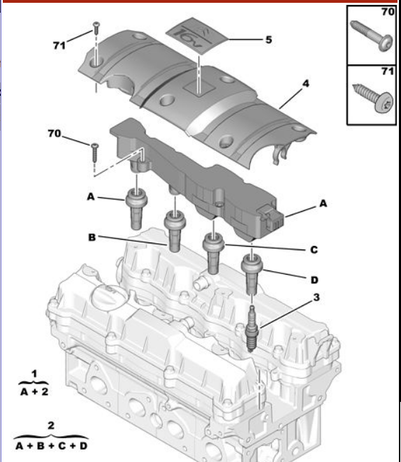

You have the Bosch 7.4.4 Engine ECU on your C2.
The Coil Pack part is: 597099. £138.42 from Citroen inc. VAT
There are others available on the bay, but quality will vary.
https://www.ebay.co.uk/itm/Ignition-Coi ... 2054397425
Unfortunately there isn't anything else I have on that code and without a Lexia diagnostic, it will be hard to get a proper idea of what it is.
