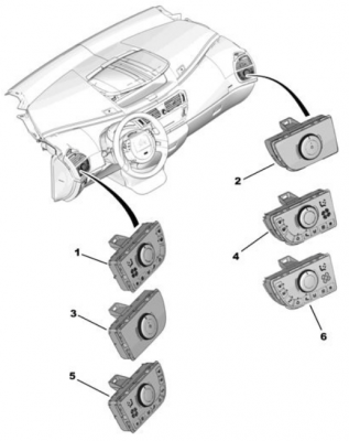

I would suggest a diagnostic to obtain the fault code so that you can better ascertain the specific problem. There are quite a few listed.

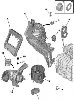

You only have parts: 1, 2, 3. 4. 6, 8 & 9 on your vehicle.
No 3 is the Heater Motor Control Module.
It is part number 6441 CE.
In this Diaggram, item 10 is the air heating resistance - so I hope you didn't change that as it won't affect the motor.You have heater control variants 3 & 6.

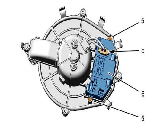

This is the actual Heater Module Blower Module attached to the Blower Motor.
Without a diagnostic to help pinpoint it, there's no way to know for sure whether the fault is in the control panel on the dash or the blower module itself.
I expect if there is any thermal fuse, it will be integrated into the control module.
