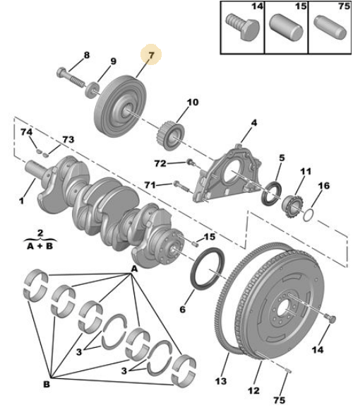

Hi guys my MK1 C5 2.0hdi 90hp has had the crankshaft pulley go all loose. Anyone have any experience with buying a replacement part for this?
I've had a look online and have found prices ranging from £35 - £130.
Crankshaft pulley.

Is it the solid one or the dual-mass version?

Re: Crankshaft pulley.
0515 V6
DOUBLE DAMPING PULLEY
DIAM 162X30 EP 37 6V
- UNTIL RPO 09337
0515 S4
SINGLE DAMPING PULLEY
DIAM 158 EP 36,8 6V
- SINCE RPO 09338
- UNTIL RPO 09337
0515 S4
DIAM 158 EP 36,8 6V
- SINCE RPO 09338
- x 6950
Post or PM your VIN if you don't know which one you have and we can confirm it.

Probably not, here's what my pulley now looks like. https://drive.google.com/file/d/1DUAR29 ... p=drivesdk
- x 6950

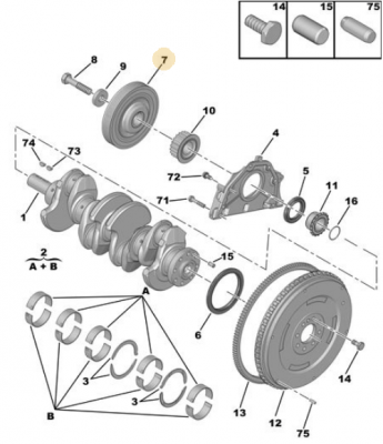

It is a double damper pulley for this model, item 7 above and Part number 0515 V6
About the cheapest I've seen for a genuine NEW one here: £49!
https://www.ebay.co.uk/p/Peugeot-0515V6/1315457383
GiveMeABreak wrote: 17 Jun 2018, 13:34 It is a double damper pulley for this model, item 7 above and Part number 0515 V6
Your a star for that link. Just brought it. If my current broken one is the original then I guess that new one will outlast my car. (It's 18years old with 125000 on the clock, came with no service history or receipts).
I'll nip down the local independent motorfactors on Monday to get a new drive belt just under £15 from them so not worth sourcing online.
