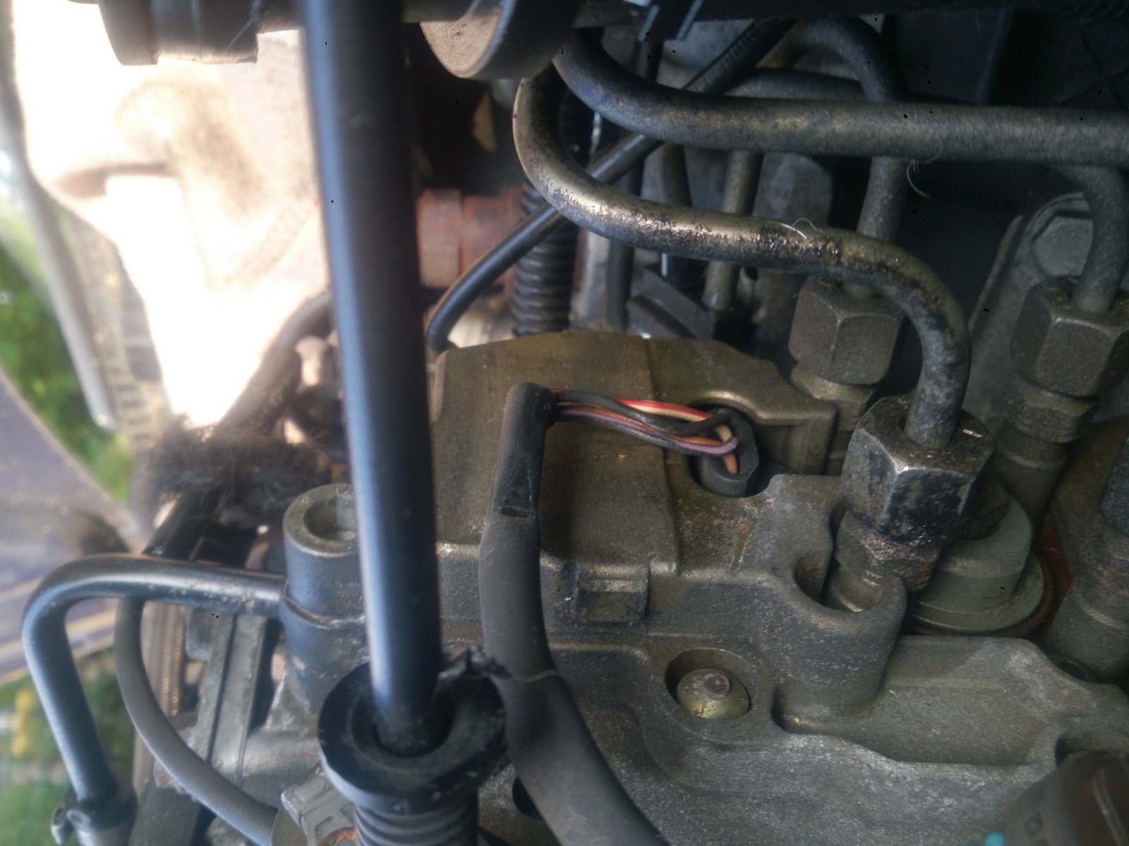

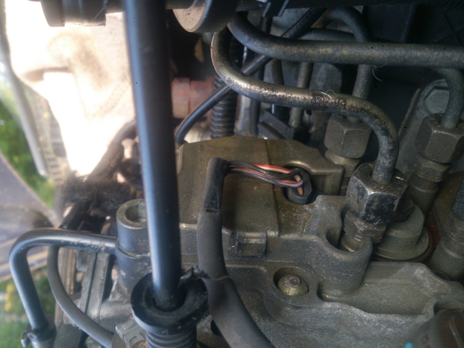

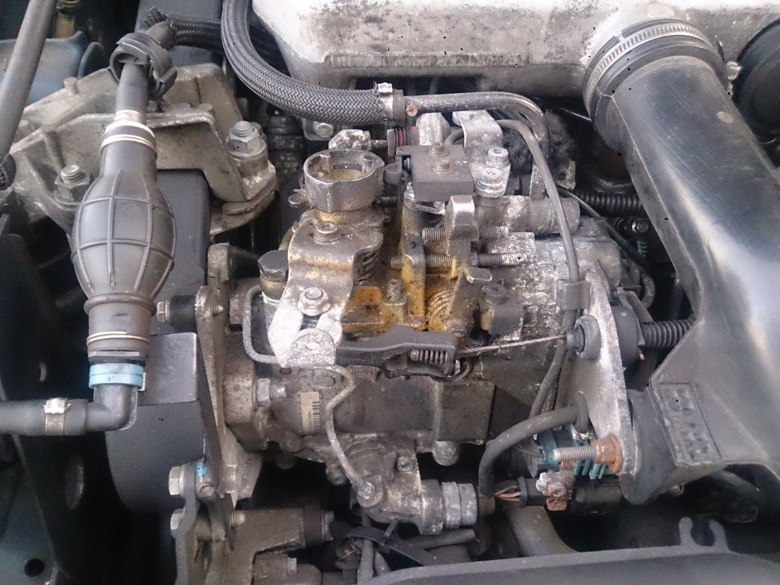

I have received an interesting comment from another forum i posted same problem to. Suggestion is that it was not the stop solenoid i changed. The actual stop solenoid being behind armour. Will update after some research. Can anyone confirm if this pump Bosch part 0 460 484 132 has armoured stop solenoid? What is the purpose of the other push solenoid?
This is back of pump.
The solenoid i changed is at bottom of pump.

Take a look at http://eastment.net/boschpump1.htm which is Jim's stripdown of an armoured pump. I think that pumps were only armoured when fitted to a car with an immobiliser (otherwise there is little to protect).

The first picture shows the armour protecting the stop solenoid, is it yours?modmytop wrote: 12 Jun 2018, 19:54 I have received an interesting comment from another forum i posted same problem to. Suggestion is that it was not the stop solenoid i changed. The actual stop solenoid being behind armour. Will update after some research. Can anyone confirm if this pump Bosch part 0 460 484 132 has armoured stop solenoid? What is the purpose of the other push solenoid? DSC_4487.JPG
The solenoid in the second picture affects the injection timing.

Thanks guys. So it was armoured all along! Is there anything I can check re the wiring to the immobliser? Presume there is a chip in the key, which is read by ignition barrel pick up? Is there anything else to check before tackling armour?
