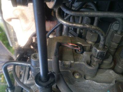

I have received an interesting comment from another forum i posted same problem to. Suggestion is that it was not the stop solenoid i changed. The actual stop solenoid being behind armour. Will update after some research. Can anyone confirm if this pump Bosch part 0 460 484 132 has armoured stop solenoid? What is the purpose of the other push solenoid?
Back of pump
Back of pump
This is back of pump.
The pump
The pump
The solenoid i changed is at bottom of pump.

modmytop wrote: 12 Jun 2018, 19:54 I have received an interesting comment from another forum i posted same problem to. Suggestion is that it was not the stop solenoid i changed. The actual stop solenoid being behind armour. Will update after some research. Can anyone confirm if this pump Bosch part 0 460 484 132 has armoured stop solenoid? What is the purpose of the other push solenoid? DSC_4487.JPG
The first picture shows the armour protecting the stop solenoid, is it yours?
The solenoid in the second picture affects the injection timing.
