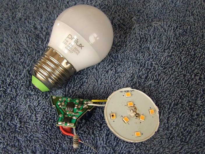

Had a series fail here, brand as per photos, with a rating on the package of 40,000h. That's a cool 22 years, at 5h per day. Really? No, they managed a couple of years, then pop...pop...pop and died.

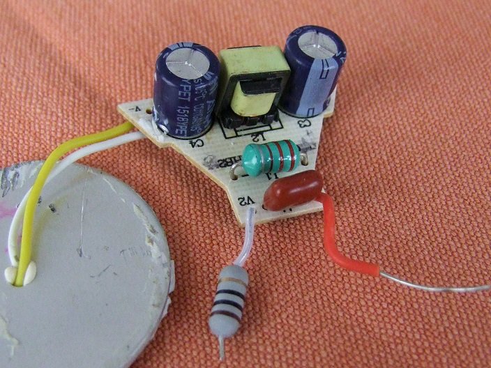

Took one apart, just to see what was crammed into the small 'golfball' E27 package, and this was it:
I know electronics are cheap, but was surprised how much that double-sided board contained. A recycling nightmare!
A clutch of better quality similar has now been fitted in the kitchen.

I have heard that it is the driver that fails rather than the LEDs. Doesn't help much as replacing or repairing the driver isn't much fun.

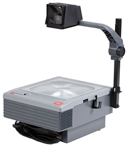

Remember (from the 70s and 80s) overhead projectors (OHPs) used to run on a 230v 650W halogen lamp (an A1/233). Cost about £6-10 each, and lasted 25h if you were lucky.
Then came the A1/223: 24v 250W. Small, short, stubby filament, bi-pin. Fraction of the heat, rugged, and actually brighter. Point source of light, so better focus through the optics. Cost was £1.10, and life 50h+, more if you under-ran them very slightly.
Soft-start transformers would extend life even further. In Education, converted thousands of OHPs across the world from the old lamp to the new, using Rank Tutor-2 slide projector parts (lampholder + transformer). Never looked back.
No-one today knows what an overhead projector is, of course.

An overhead projector (OHP) uses an A4 or 10x10" glass platen, on which is placed a sheet of film, printed or drawn with transparent inks, or opaque text (eg from a photocopier). It's lit from underneath, and the image is projected with the overhead mirror/lens.
A shallow dish placed on it, with water and small fish,** provides animated relief from OHP-transparency boredom*.
* This has now been replaced with PowerPoint boredom, delivered by laptop and digital/video projector.
** Alternatives include oil-water mixes, creepy-crawlies, ripple-tanks (ask the Physics teacher), popcorn (if very patient).
