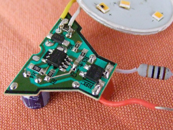

Had a series fail here, brand as per photos, with a rating on the package of 40,000h. That's a cool 22 years, at 5h per day. Really? No, they managed a couple of years, then pop...pop...pop and died.
Took one apart, just to see what was crammed into the small 'golfball' E27 package, and this was it:
I know electronics are cheap, but was surprised how much that double-sided board contained. A recycling nightmare!

I have heard that it is the driver that fails rather than the LEDs. Doesn't help much as replacing or repairing the driver isn't much fun.

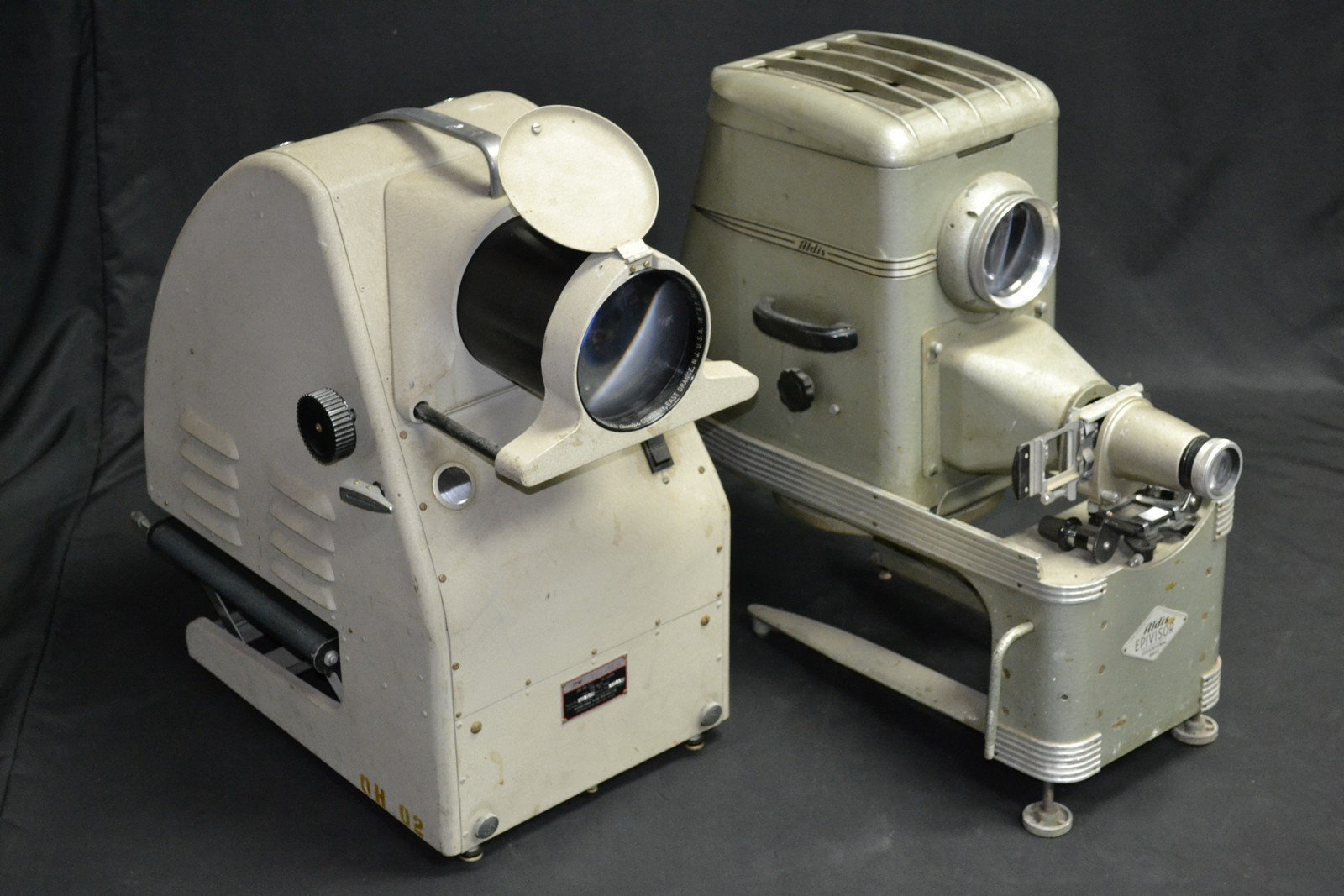

No. Left: Episcope Right: Epidiascope
An episcope is able to project an image from a flat printed sheet/book/map/drawing/flattish object.
A diascope is a slide projector, projecting a small transparent slide or still film, 35mm or otherwise.
An epidiascope is able to do both, having two lenses and optical systems.
