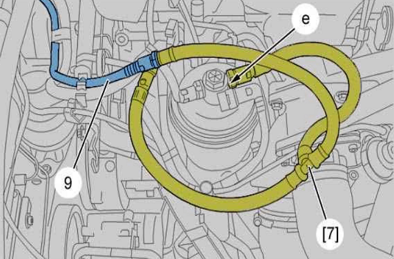

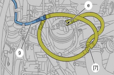

Ok, so for your engine, they recommend using a tool to bleed the system - which is highlighted in yellow in the diagram - and instructions follow:
  • Couple the female union (10 mm) of the tool [7] in place of the pipe (3), as "e".
  • Disconnect the fuel return pipe ( 9) and insert the union (Ø8 mm) of the tool [7] into the fuel return circuit.
  • Switch the engine on and off 10 times in order to fill and bleed the fuel filter.
Remove:
  • The tool [7]
  • The tool [6] from the pipe (3)
  • Couple up pipes ( 3) and (9).
  • Switch the engine on and off 2 times

GiveMeABreak wrote: 06 May 2018, 18:59 Ok, so for your engine, they recommend using a tool to bleed the system - which is highlighted in yellow in the diagram - and instructions follow:
I don't quite understand the image... I already have all those pipes and the three-way separator - "the tool" (it can be seen at the beginning of the video I've posted). I just need to reconnect them in a specific order, switch the engine on and off 10 times to bleed the filter and reconnect them the way they were connected before the procedure?

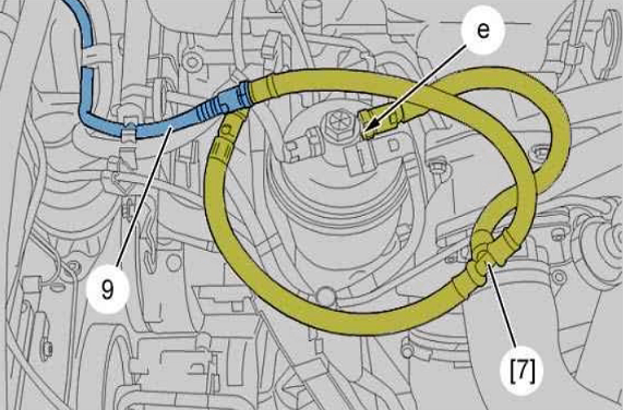

So basically once you've disconnected the pipes, opened the bleed valve and removed the fuel filter to clean or replace, fitting is a reverse - and bleeding is using the tool as described. I've included another diagram to show the pipe (3) that they are referring to at 'e' in the third diagram.
