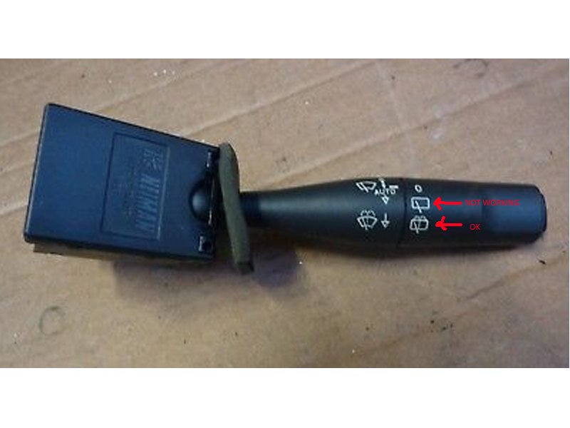

I have bought my new 306 HDI estate 2001, last week I knew the rear wiper was not work I can fix it. Today look on fuse in interior found a 20amps is missing, so I insert fuse, when I turn the stalk on first switch should be move all time but it do nothing, when I switch further for the water the wiper is coming on wiper 5 times then stop but the water is not function? as I have notice the front auto rain sensor is not working but it works on manual speed one and two also front water jet is work as well.
Is this relation to relay on motor or motor faults or stalk fault or sensor?

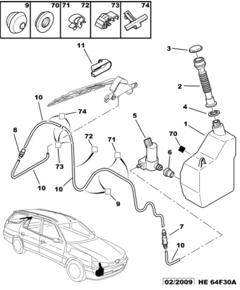

I would opt for the pump first - very rare for the reverse wash stalk part to go on the Comms Unit, as it is used a lot less in comparison with the front I suspect.
I would test the pump first - here's the part number and new price if you need it
Part number (5) in the DIagram is PSA Part No: 6434 60 £55.52 From Peugeot inc. VAT |
Re: 306 wiper not work correct.
GiveMeABreak appreciate! for the picture and the code.

Got a new pump from my local car parts for £7.49. I have fit it the rear jet it works but the rear wiper is come on only the second switch but the first switch do nothing!. The fuse are fine, the motor I took it off and put on 12volts battery it go nice smooth it has to be the blue relay fault?
On Friday my local Autoelectric found wire has been cut in a half where the rubber hose between the body and tailgate. This is what cause the wiper not work on the first switch.
