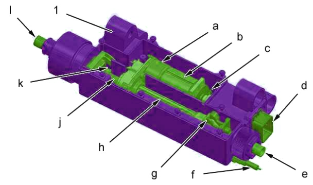

Here's the inside of the unit for those interested:
Not shown is the separate control and cable for the manual release mechanism.
| (1) Automatic electronic parking brake. "a" The reduction motor "b" engine "c" Rotation sensors "d" Connector "e" Electric parking brake rear right secondary cable "f" Manual release cable "g" Release mechanism (Manual) "h" Splined shaft "j" Threaded pin "k" Integrated force sensor "l" Electric parking brake rear left secondary cable |

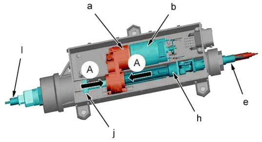

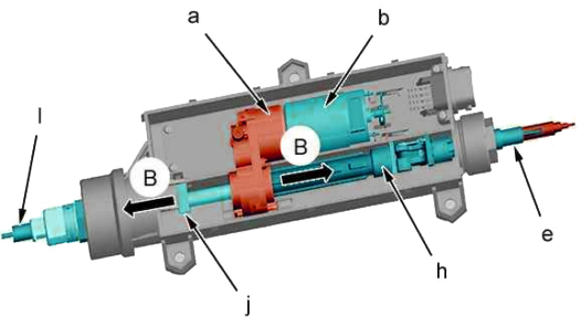

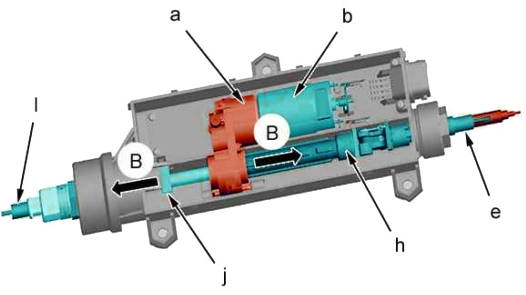

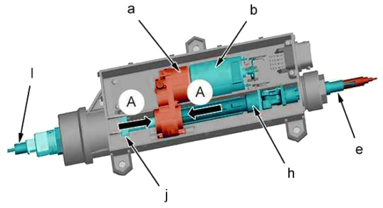

| Tightening Action | Slackening Action |
| EPB ECU controls motor "b" in application direction "A" | EPB ECU controls motor "b" in release direction "B" |
| Force provided by motor "b" is reduced & sent by reduction motor "a" to splined shaft "h" | Force provided by motor "b" is reduced & sent by reduction motor "a" to splined shaft "h" |
| Splined shaft "h" & threaded pin "j" are linked by interior thread of splined shaft "h", the rear left | Splined shaft "h" & threaded pin "j" are linked by interior thread of splined shaft "h", the rear left |
| Secondary cable "l" is linked to threaded pin "j", the rear right secondary cable "e" is linked to splined shaft "h" | Secondary cable "l" is linked to threaded pin "j", the rear right secondary cable "e" is linked to splined shaft "h" |
| The rotation of splined shaft "h" in application direction inserts threaded pin "j" in splined shaft "h", which draws in right & left secondary cables | The rotation of splined shaft "h" in release direction extracts the threaded pin "j" from splined shaft "h", which distances right & left secondary cables at "B" |
| The drawing in of right & left secondary cables applies rear brake calipers | The distancing of right & left secondary cables at "B" releases rear brake calipers |
- Posts: 11831
- Joined: 28 Mar 2013, 21:05
- x 2003
Re: C5 X7 Electronic handbrake cable
Yep, a simple lever and cable is just too complicated
